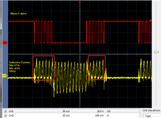

    Regarding CMPB the SDK v2.1 SVM transform does not load any value into CMPB as configured above code snips. I was attempting to configure an AHC asymmetric PWM generator pair and that requires CMPB to be static loaded for a fixed duty cycle. Also requires DB mode 2  with S4,S5 mode change, see TRM Fig.18-33. This type of asymmetric DSP mode produces slow current decay in high side MOSFETS typical of trapezoidal FOC commutation.
    The EPWM module via AHC dead band still produces 1/2 wave current pulses on the ends of  PWM full cycles. Do you think asymmetric PWM can arrest 1/2 wave current cycles from being developed or is something else causing them? I'm not a big fan of period direct load register writes, can that lead to this 1/2 wave current pulses being described? Yanming does not seem to get what I'm describing is/was seemingly a defect in Instaspin FOC SDK performance. 50% of the time issues are related to module configuration and the other 50% SW.
    Red boxes CH2 are 1/2 wave pulses cause motor to crash into acceleration trajectory never to reach rated speed. This capture CH1 represents fast decay PWM mode. Seemingly EPWM needs CMPB nearly 100% duty cycle to generate (slow decay) sinusoidal waves (red boxes). How CH1 PWM produced inductive sine wave is amazing but lacking consistent sinusoidal current generation CH2. Seemingly that was not the intent of the Instaspin motor FOC and EPWM can produce robust sinusoidal inductive current at all times even from lower duty cycles.

  • Does it look like capture red boxes are proper modulation CH1 to produce full sinusoidal inductive current CH2? It's hard to determine that question  via 2 channel scope Cold sweat

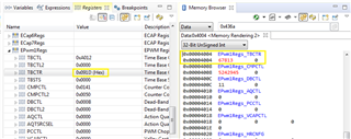

  • matching time base multiples of compare counts CMPA
    Perhaps you didn't see the memory mapped CMPA count register is 16x the value of CMPA match count and TBPRD. The count has appended 16 bits left shifted << the contents, the real TBPRD count is loaded 2500. Why is the memory mapped CMPA decimal count 16x higher than the matched CMPA value?
  • No change to very high CMPA memory mapped count even when period load is selected. Other type PWM memory mapped CMPA count go to zero and count starts over. The action qualifier output A on CMPA up and down counts. The period count is 2500 and the loaded CMPA match is 1250 decimal.

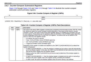

  • Thats the combination of CMPA + CMPAHR.
    CMPA left shifted + CMPAHR
  • Just look at the CMPA not the combined CMPA (large value)
  • Who on earth would ever know that by what GEL file has loaded. But still the memory mapped value never resets to zero or counting up on CMPA match counts.
  • the memory mapped value never resets to zero or counting up on CMPA match counts
    I'm not following. What is not counting up?
  • Yet CMPAHR registers are all disabled, So shifting left 16 bits seems to confirm high order byte CMPA match counts are occurring against the TBPRD module at higher counts then actually loaded. The single period are correct (50µs) but the cycle is longer than it should be. The extra undesired 1/2 wave pulses (red boxes) have to originate from some where. The phase current is supposed to be sinusoidal for the full TBPRD cycle, no interruptions as occurs.
    Note the wide breaks between EPWM module A output CH1 is not consistent to industry standard 3 phase sinusoidal current generation. The phase control registers PHSEN were all disabled SDK v2.01 motion FOC but TRM Fig.18-67 shows only EPWM1 CTR zero, NO Synci. I added change below synci, synco for EPWM 2,3 modules and still no change in the match counts CMPA. The memory mapped CMPA register should not free run in up counts, when CMPA match occurs the count should stop and count down to zero. The emulation mode control is only for CCS debug standby free run time, not execution time. So we should see the memory mapped CMPA count up and back down with TBPRD.

  • CMPA in the registers view is:
    CMPA            combined version of CMPA and CMPAHR (the decimal value is not the the actual fractional value of the total CMPA with CMPAHR
         CMPA       actual value of the CMPA
         CMPAHR
  • What is not counting up?
    That's all it ever does there is no change when the CMPA match action event, until pausing CCS debug. That may be an emulation issue making it seem that TB module is not synchronous with counter compare sub module. I expect the memory mapped count and CMPA count value only latches when match occurs TRM Fig.18-18 and Fig.16-68.
    How else can we verify CMPA match to count is actually occurring via CCS debug?
            /* set comparator control load mode for default shadows CMP-A or B */
             EPWM_setCounterCompareShadowLoadMode(obj->pwmHandle[cnt],
    											  EPWM_COUNTER_COMPARE_A,
    											  EPWM_COMP_LOAD_ON_CNTR_PERIOD);
    Oddly we switch to decimal view for CMPA memory mapped GEL cell and the value is not only <<10, the TBPRD count value is extremely high. Sorry, forgot to mention that Weary.
  • No the value immediately gets set in the register. But it will be shadowed to an active register that is NOT shown to users when the event occurs.
    The problem seems to be CMPA counter compare register bits exist high order Dword (<<10) unrelated with memory mapped counts TBCTR register. The EPWM_setCounterCompareValue() call adds 0x1 to the offset address. So CMPA 0x6A effectively offsets 0x6B?
    Perhaps CMPA compare should shift the results (<<10) to compare memory mapped TBCTR counts with CMPA high order Dword bits or is that assumed?

  • Decimal view of TB count indicates the entire 32 bits are being used for the TBCTR counts (CMPA, CMPB) low resolution register contents located in the high order Dword. The period load is only 2500 but memory mapped decimal counts of (TBCTR) register for CMPA have excessively high compares from combining high/low order Dwords of the memory mapped CMPA.
    The actual TBCTR compare value depends on the instruction decodes of the memory mapped register. Seemingly CMPA compares the memory mapped count of TBCTR since 16 bit word register remains for the most part a steady state value.
  • GI,
    Again the decimal fortmat should be used on the
    CMPA
              CMPA -> this one
    NOT THE COMBINED CMPA register. The CMPA bitfield
  • Again the decimal fortmat should be used on the
    Perhaps you actually meant to type 32 bit decimal value should (NOT) be used CMPA.  Agree But...
    However the memory mapped count from TBCTR is 24 bits into (CMPA), the count being compared.  Seems to explain >170ms EPWM-A/B low state signal voids (capture CH1, CH2). The Instaspin PWM interrupt decimation time (328µs), scope measured via GPIO port.
    How can there be No PWM pulses >170ms void space unless the TBCTR 24 bit value is being compared to CMPA. CMPA 16 bit register value remains static in steady state power generation time. CMPA memory mapped decimal count should not be as high, HRPWM is/was not enabled!
    Again the period is fixed (2500) counts 50µs, only the Pulse Width may vary dutycycle via CMPA updated load counts compared to TBCTR value. The CMPA compare surely seems to occur against 24 bit TBCTR memory mapped HRPWM decimal count. Note too Vsense EMF feed back to Clarke occurs inside the PWM void time, capture below figures.
    There is way to much dead air time in the EPWM generated outputs. As result the sinusoidal current wave form being generated CH2 has >170ms idle time in my steady state example. Note too TRM omits HRPWM registers detail for TB, TBCTR, CC sub modules.
    Can you elaborate how >170ms PWM voids might otherwise be occurring as Instaspin interrupt decimation time is 328µs?

    Wow x49c has 24 bit CMPA registers according to MCU datasheet, TRM figure above is dated. The original SDK v2.01 project was built using generic C28xx device tool chain. But change Lab5 tool chain TMS320F28049C noticed 170ms void issue and did not check the GEL versions on either CCS debug runs.
  • CMPA is 16 bits. Then CMPAHR most significant 8 bits.
    Together CMPA = CMPA + CMPAHR 24 bits total.
  • Agreed but the HRPE=0x0 not enabled so the 24 bit decimal TBCNT confuses 16 bit register match value, no matter CMPA +1U Bits 31-16 location.
    For a test I loaded CMPA value into Bits 15-0 and mem-mapped decimal count (1024) matched exactly the load value CCS debug but it only made EPWM-A state go high stay high. May try CMPAHR load values for match with 24 bit TBCTR values. That seems to be where count contention exists producing 170ms wide blank PWM cycles?
    It seems CMPA register location is reversed, CMPAHR should occupy bits 23-0 and CMPA bits 15-0, not the way it now exists. The 24 bit TBCTR count exceeds CMPA 16 bit load values by very large sum.
    Why does TBCTR default to a 24 bit wide count and CMPA only 16 bits wide, HRPE=0x0? Also only 16 bit wide load shown Fig.18-127 CMPA register not 24. Perhaps register layout was never update TRM to show HRPWM might ever do match counts via CMPAHR 24 bit updates? With TM4C TI family MCU registers 16 bit value existed 15-0 and 24 bits simply appends 8 bits to counter loads via bits 23-0.
    TRM SPRUI33D – NOVEMBER 2015 – REVISED SEPTEMBER 2020 Fig.18-127 CMPA register does not properly convey to readers any such condition. EPWM module seems to default mode 4 (HRPWM) as TBCTR counts are 24 bits wide, CMPA load value bits 31-16 match count truncates? Seemingly TBPRD into counter compare sub module should not be allowed to exceed CMPA match count load values. That condition seems to add phantom periods to the CMPA match counts.
  • You are correct the 24 bit is only applicable when HR mode is enabled.
  • only applicable when HR mode is enabled.
    Oddly the figures above indicate 24 bit CMPA and CMPAHR as +8 = 32 bits. Opposite of CMPA register Fig.18-127. That was the point I was trying to convey, an inconsistency exists. Counter compare sub module defaults 24 bit active bus, +8 is full 32 bits (uint_32t) CMPAHR in above figures.
    CMPA register x49c tool chain layout (2x16) does not indicate +8 structure exists. Determining TBCTR memory mapped read by visual compare of CMPA match count can not be determine via CCS debug.
    We can only determine TBCTR match occurs when CMPA value force loaded into low order bits (15:0). Then things get funky, 16 bit digital comparator match count logic fails to properly latch up/down action events. Low resolution CMPA bits should load (15:0) and high resolution 24 bits +8 adds to left of the first 16 bits for (23:0), total of 24 bits left to right in a 32 bit register, not two 16 bit registers.
    The tool chain + GEL file does not exactly match the datasheet register figure of counter compare sub module bus notations. It can't be loaded both ways, that is the point of contention, seemingly voids occur from unmatched count events. Yet the PRD is exactly 50µs with duty cycle and odd blanking voids 170ms. No DC blanking is enabled, only the edge count filter is enabled so doubtful 170ms voids from that.
  • No no, the CMPA standard is and always have been 16 bits. The HR added makes it 24 bits.
  • The HR added makes it 24 bits.

  • Yes on Type 4:
  • This chapter guide is applicable for ePWM type 1. See the TMS320x28xx, 28xxx DSP Peripheral
    Reference Guide (SPRU566) for a list of all devices with an ePWM module of the same type, to determine
    the differences between the types, and for a list of device-specific differences within a type.T
    This chapter includes an overview of the module and information about each of its sub-modules:
