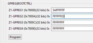

    I'm trying the On-Chip Flash GUI in CCS and it looks like the OTP values are not getting programmed with the values I provide.
    These are the values I'm setting for Z1-GPREG1 and Z1-GPREG2 (Z1-BOOTPINCONFIG, Z1-BOOT-GPREG2)
    Then after I hit "Program" the Console outputs prints what I highlighted in yellow here:
    However, reading back those registers with an expression watch returns all FFs
    Additionally, after I power cycle I still see all FFs in the expression watch and the device does not boot to Flash as would expect it to.
    I also verified that the values I provide for BootPinConfig (0x5AFFFFFF) and BootDef (0xFFFFFF03) are valid by using the Emulation approach, i.e. writing 0x5AFFFFFF to address 0x00000D00 (EMUBOOTPINCONFIG) and 0xFFFFFF03 to 0x00000D04 (EMUBOOTDEF-LOW).
