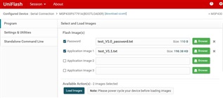

UniFlash Settings
"test_V1.0.txt" was already loaded at this point and we select the password file for V1.0 software.
"test_V1.1.txt" is selected to be loaded into the device, which will overwrite V1.0 software.
My understanding is that the selected Password file must match the password data currently programmed into the device - so in this case the password data for V1.0 software.

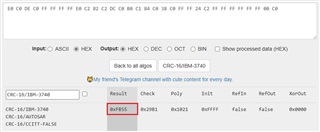

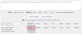

CRC Calculation
I used the the online crccalc tool to calculate the expected CCITT CRC for the old and new passwords.
V1.0 (old) password = 0xA366
V1.1 (new) password =  0xFB55

[2/10/2025, 6:55:02 PM] [ERROR] MSP430: CRC check at 0xFFE0 does not match; expected value: 0xA366 obtained from BSL: 0xFB55
When verifying the new code, it expects the CRC to be 0xA366 (but this is the old password CRC) and obtains 0xFB55 from the device (this is the correct, new CRC).
