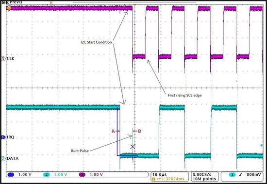

We're using the MSP430F5438A connected to a ZSC31014 bridge amplifier chip using the I2C bus in master mode, from the MSP's port UCB3. Our I2C bus uses 4k7 pullups.
We've been having a problem that the MSP4305438A's I2C port produces a glitch spike on the SDA line, between what we perceive to be the end of each start bit and the beginning of the MSbit 6 of the address byte, as follows:

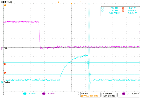

Zooming in on the glitch pulse:
We fully understand that this glitch spike should not matter to I2C operation. However, unfortunately the ZSC31014 datasheet (on page 24) states that its I2C port departs from the normal I2C specification: "A falling SDA edge is not allowed between the start condition and the first rising SCL edge. If using an I2C address with the first bit 0, SDA must be held low from the start condition through the first bit."
This combination of the MSP430 I2C glitch pulses, and the ZSC31014's susceptibility to them, resulted in us having reliability problems with this chip. Our workaround is to configure the ZSC chip to have an address with its bit 6 set (e.g. we’re now using 0x42) - this turns the glitch pulse into a nice clean "high" bit for the address bit 6 duration, which gets rid of the problematic falling edge.

  • The undershoots are not produced by the device but by the hardware behind. Strange is in your magnified screen-shot there are no undershoots, probe capacitance? But this is not your actual point.
    The short transition on the SDA line might not be nice but they are part of the START arbitration and also fully into the specs of I2C. I don’t think TI can give you a solution, the problem is the ZSC31014 device. Maybe you can solve it by adding a little capacitance on the SDA line (not nice but..).
  • The I2C Data is designed to be driven low (with an open collector) by one of many devices. When none of them is driving it low, it is pulled up (slowly) by a resistor. I think this is what causes the glitch.
    (1) If the address is an odd number such as 0x41, I2C Data is high to begin with. There is no glitch and no changes are needed. Only when the address is even, where I2C Data begins as low, there will be a glitch. I think there is a firmware workaround to avoid that. This workaround is described below.
    (2) The I2C Data and a GPIO share the same pin. We could set up that GPIO as out-low. Normally that shared pin is selected as I2C Data, thus GPIO being out-low is inconsequential.
    (3) However, shortly before point A, as shown in the picture below, the firmware could select that pin as GPIO. And shortly after point B, the firmware could select that pin as I2C Data again. Thus between A and B, that pin is constantly driven low by that GPIO (shown in blue) and no glitch will show.
  • Mm… I don’t know how MSP is exactly handling the signals, but pulling SDA low normally results in a Bus-busy state, A can give a problem. And also B can lead to an arbitrage lost, while SDA remains low and the master is recognizing this as a Start from another master and will give-up.
  • OCY: right. When clock goes low, the data pin is released by the state machine, before it is switched to the state of the bit to output. During this time, the pull-up pulls it up. This is totally valid. During SCL=0, the SDA signal can change as often as it wants.
    However, if the slave is apparently not 100% compliant to the I2C standard, knowing the reasons doesn’t help.
    LEO: the bus is always busy after a start and before a stop is received. It has nothing to do with data held low.
    However, if data is held low while the USCI wants to output a high, this is considered an arbitration loss. Now in this condition, the USCI wants the output to be low. It’s just during the state transition, that the output pin is temporarily released.
    BTW: I see the bit time and the glitch time and the size of the glitch. I’d say, the pull-up is way stronger than required. A larger pull-up might solve the problem, as during the glitch time, voltage won’t rise that fast anymore.

  • Leo, pulling SDA low by port IO while it has been already pulled low by USCI for start condition, to gap the glitch, leads to bus busy while bus is already busy. That was the idea and suggestion. Of course, simply pulling the line low at some random time is not working and wasn’t suggested.
     BartW, the glitch time is pretty short compared to the I2C clock frequency. So you apparently have a really low capacitance bus. Yes, 4k7 are pretty much standard, but in in most cases, 10k do fine. You can try a combination of both, raising the pull-up and adding some load capacitance to the bus.
