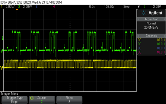

  • Both codes look good (well, the second is only a stub, but should produce at least a valid start byte).
    So it seems to be a hardware problem. The analyzer graph seems to show an open high-impedance signal that generates spikes. You say the external pull-ups are in place. And is there a GND connection between master and slave?
    It would be interesting to see what a scope produces (the real waveforms on the pins, not the interpreted logic levels).
  • I have redone the test with the logic analyzer and a probe they look similar and correct (not sure what was going on before). That being said I still can't get the module to send a sequence I want it to, I will attach pictures of the output and of the code.
    The logic analyzer traces are consecutive basically one long trace cut in three.
      This is the first part of the trace
      This is the second part of the trace
      This is the third part of the trace
    The Scope traces are randomly grabbed as it is not possible to get one long and useful trace.

    If you have any suggestions to get the module to send a start, 0xc0, 0xc0, 0xc1, read byte, stop that would be great because as of now I can't even get it to send start 0xc0, 0x0c, 0x0b in a predictable pattern.
    Kas
    Do you have any further suggestions ?
    Sorry for the late response. For some reason, I forgot to post my answer to your post adn Roelof's response. Here it is: (I'll look into your code form monday as soon as I find the time)
    For UCB0, P3SEL|=0x03 is correct.
    UCB0BR0=12 indeed doesn’t set 100kHz. It is not a baudrate setting but a clock divider and divides the selected clock by 12. While on 2x family (where the demo code originally comes from), the default frequency on some MSPs is ~1.2MHz, it is 1.01MHz on the 5x/6x family. So it results in ~84kHz here. A simple case of copy/paste error which makes it difficult to understand its meaning for those who read (and copy) it later.
    In your code you set UCB0IFG=0xFF. This ‘simulates’ all possible interrupts and is most certainly not what you want. Set it to 0 instead, to clear all possibly pending interrupt sbefore beginning a transmission.
    In your while loop, you set UCTXSTT to send a start byte. Then you write 0x0c to TXBUF. But then you immediately overwrite 0x0c by 0x08. Remember, the start byte is currently  being sent. The slave hasn’t been addressed, has not responded, and no data has been sent yet.
    Next, your code waits for UCTXSTP, which you never set, is clear. SO the code immediately loops, sets UCTXSTT again, overwrites TXBUF twice and so on. So all you get is a chain of start conditions.
    After setting UCTXSTT and writing the first data byte to TXBUF, you need to wait until TXSTT is clear. Then check for UCNACKIFG (to see whether the slave perhaps didn’t answer). IF it did, wait for TXIFG being set (to signal that TXBUF can take the next byte). Then write the second byte to TXBUG and wait for TXIFG once more. Once this happened, you know that the first byte has been sent, the second has started sending, and you may now send a stop (by UCTXSTP) or go into a repeated start. (note that some MSPs require a delay between stop and the next start due to a silicon erratum)
