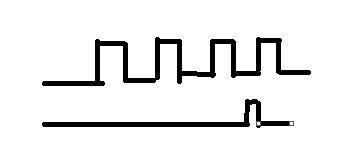

  • My usecase is that I need a PWM for sample/hold of a signal and the sample/hold circuit is connected to an integrator circuit ( op amp with RC)..
    So I need the other PWM for resetting my output to zero after a specific time.
    The first PWM is my sample/hold pulse and the second one is my reset PWM. I need the reset PWM to go on a high just before  and come back the fourth cycle of sample/hold.
    my sample/hold timeperiod is 4ms and top level duration is 20 microseconds. and the top level duration of my rest is 10 microseconds.
    Can such a system be configured using MSP430 alone..
  • The signals you are describing are not PWM signals; please do not call them "PWM".
    As far as I can tell, the outputs should cycle every four milliseconds. However, the timing of the pulses is not clear. Please describe exactly when the two outputs should go high and low.
  • It seems you have a periodic signal that has a period (sampling frequency) and a duty cycle (sampling time). This can be done using PWM. Your second signal also have a period (time between to integrator resets) and a duty cycle (duration of reset). However, the two have two different periods and therefore cannot be automatically generated by one timer.
    Either you get an interrupt with the same frequency as the sampling PWM signal, count the samples and manually set and reset the reset signal (the reset of the reset signal can be synchronized to one of the PWM signal edges, but not the start), or you route the PWM signal output as clock input to a second timer, where you can set the number of periods per reset cycle. But the reset pulse will then be synchronized two rising edges of the sampling PWM signal.
    What you have drawn is not possible in plain hardware and requires CPU support - with its inherent jitter and latency.
