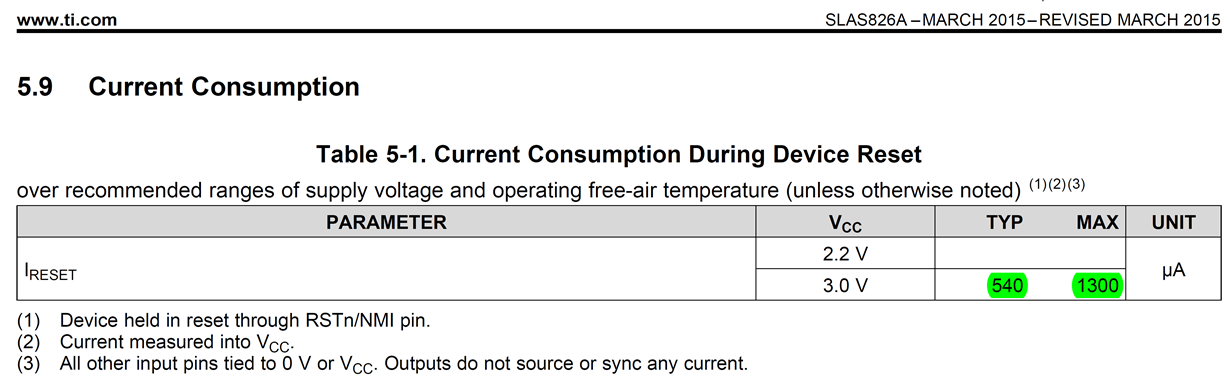

    Also while in reset state,
    Current during reset state should be around 1 mA referring to device datasheet. Hmm...
