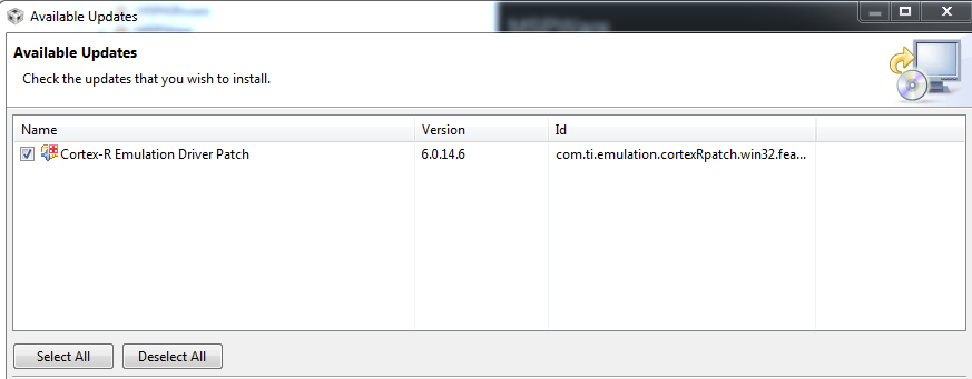

  • I hope someone can help. In case someone suggests I apply the recent Cortex emulation patch, I already did without any luck.
    I was really hopeful.
    Any help is appreciated.

  • Hi David,
    I received the board yo sent and was asked to first allow an update for the debugger. It said "do not unplug the debug probe" while update was taking place. I did that, and here's the error message I got:
    CS_DAP_0: Error connecting to the target: (Error -1040 @ 0x0) A firmware update is required for the debug probe. Click the "Update" button to update the firmware and connect to the debug target. DO NOT UNPLUG THE DEBUG PROBE DURING THE UPDATE. (Emulation package 6.0.14.5)
    CORTEX_M4_0: GEL Output: Memory Map Initialization Complete
    CORTEX_M4_0: GEL Output: Halting Watchdog Timer
    CORTEX_M4_0: Flash Programmer: Erasing main memory
    CORTEX_M4_0: Flash Programmer: Writing 4040 bytes to flash memory 0x00000000
    CORTEX_M4_0: JTAG Communication Error: (Error -615 @ 0x0) The target failed to see a correctly formatted SWD header. The connection to the target may be unreliable. Try lowering the TCLK setting before trying again. (Emulation package 6.0.14.5)
    CORTEX_M4_0: Failed to remove the debug state from the target before disconnecting. There may still be breakpoint op-codes embedded in program memory. It is recommended that you reset the emulator before you connect and reload your program before you continue debugging
    And I am back to the same issues I previously had with my other two boards. I also got a brand new board in today from digikey....and I was also asked to update the debug probe. Same issues with this board. Let me know if you have any suggestions. I'm sending my original board and the board you sent me to you.
