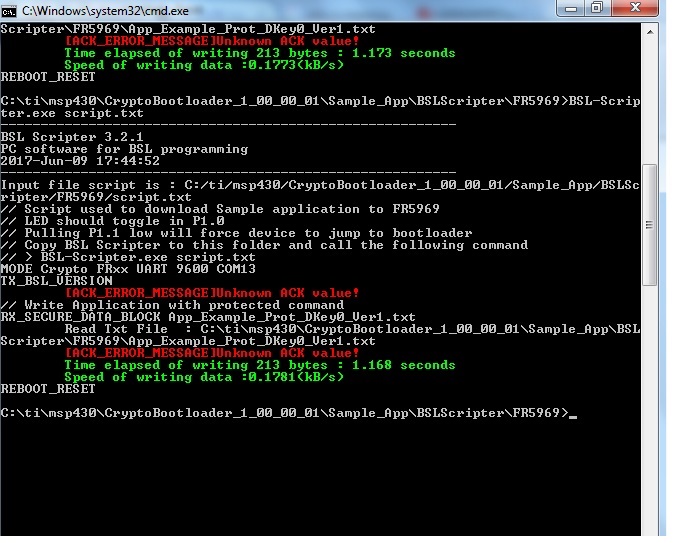

I am working on BSL Programming in MSP430FR5969 LaunchPad.
For that I have referred a ti material “Slau657.pdf”.  For the first time loading in MSP430FR5969 LaunchPad , I have referred steps given in  Section 6.1.2. Loading Crypto-Bootloader Using Source Code.
After that to load Application , I have followed  steps given in 6.2.3.2 Example Using UART With MSP-EXP430FR5969 and MSP-FET. But when I was using command prompt command, I got “ACK_ERROR _MESSEGE”[see below Figure] .
 How to troubleshoot that error?

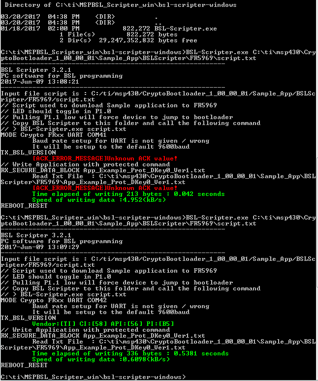

    I have duplicated your error. To resolve this, you'll need to change the COM port in your 'script.txt' file from the MSP Debug Interface COM port to the MSP Application UART1 COM port in your Window's Device Manager. For me, I used COM41 and got the "[ACK_ERROR_MESSAGE]Unknown ACK value!" error message in my terminal window. After changing the script to COM42, the programming over BSL was successful.
    I'm confident that this will resolve your issue.

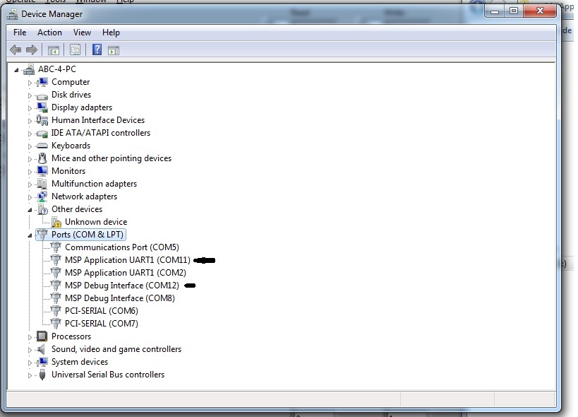

    I have selected comport as per your instruction. For device mspfr5969 , MSP debug interface [COM 12] and MSP UART Application [COM 11] was displayed. remaining com port for other devices.So I have selected COM11. Is it correct for this device?
    Thank you for sharing this screenshot. It looks like you have two MSP debug interfaces connected to your PC. To rule out that you're using the wrong COM port, only connect one at a time. Are you connecting the MSP430FR5969 LaunchPad to the PC via the USB cable as well as connecting the MSP-FET to the LaunchPad? If so, you'll want to unplug the LaunchPad from the PC, remove all jumpers from the isolation header, and keep the MSP-FET connected to the PC and plugged into the LaunchPad. Then, the Device Manager should show only two MSP COM ports, Application UART and Debug interface. In your script, you must use the COM port associated with the Application UART port.
    Please remove any other serial adapters and any other tools like this from your PC. Ideally, you only want the MSP-FET connected. I'm concerned that the numerous devices enumerated on your COM ports are causing your issues.
