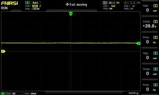

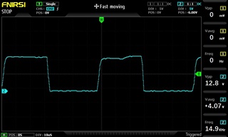

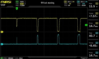

    I think to get to the root of the damage it would be helpful to see the following waveforms and their measurments:
    VDRAIN
    VCP
    SHx to GND
    GHx to SHx

  • Hi Yara,
    Please find enclosed the waveforms of my Custom Board running under below conditions.
    30v powered by Power Supply,  6 inches skateboard motor, motorVars_M1.speedRef_Hz = 150,  Speed Control mode, no-load current = 1A
    VDRAIN 29V
    VCP 39.8V
    SHx to GND
    GHx to SHx
    GHx to GND and GLx to GND
    Danny
  • Hi Danny,
    Nothing looks too concerning in these waveforms and it seems like you are well within the specs of the device, are you still experiencing issues like you did on your last board?
