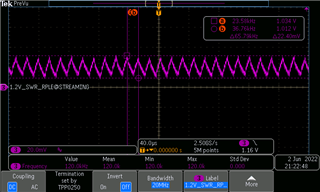

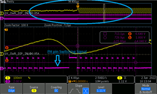

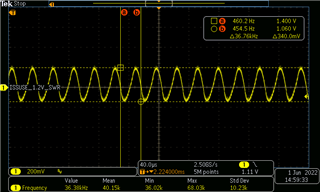

We are using the TPS5432 regulator in our design. If we give a sudden load for 1A it starts generating a sine wave as output?
I connected the regulator output side with 100mA constant load, then I suddenly added 850mA load parallels to 100mA load. after adding this it started sine wave.
Attached is a scope and schematic.
Using the same regulator we have designed for 1.2V and 1.8V too, the same issues we found on those too.
I need a little clarification regarding this issue:
scenario 1: When we provided 1A load initially from the beginning of board power-up, I'm not getting any of this AC sine wave pulse, at the time I probed the PH pin switching signal too, and it looked fine.
scenario 2: When we provided a 100mA constant load from the beginning itself, it is the same as in the scenario1, but when I'm changed the load suddenly to 1A  or suddenly disconnect the 1A load from the circuit, it started to oscillate like an AC sine wave, at the same time I checked the PH pin switching signal it is different from the scenario 1. we noticed an unusual switching on it. The scope images are attached for your reference. The output voltage level's also changed, they started varying and it did not attain its stable state. When I disconnect DC power and reconnect it becomes stable.
Note: The frequency of that AC sine wave is around 35kHz, but our actual regulator switching frequency is around 700kHz. From this I'm assuming that this is not an AC ripple by switching, the regulator itself misbehaves, please correct me if I'm wrong. Please set these scenarios in your lab and give me the solution for this issue.
The circuit we used in our design was taken from TI's Webench circuit simulator.
I have attached more scope images for your reference.

    - The sine wave frequency of 35kHz that you observe may not be the right measurement. Because this device has OVTP feature and the output voltage overshoot will be controlled. Which means the period of the sine wave could get longer without such a feature. So, it is important to understand if the system is stable with the customer BOM.

    - Can you also probe COMP pin for the following conditions:
      Case 1- constant 1A load at start-up
      Case 2- constant 100mA load at start-up
      Case 3- Load transient from 100mA to 1A
    - Layout Review to follow.

    The sine wave frequency of 35kHz that you observe may not be the right measurement. Because this device has OVTP feature and the output voltage overshoot will be controlled. This means the period of the sine wave could get longer without such a feature. So, it is important to understand if the system is stable with your BOM.

  • Hello Febin,
    This is the response from the customer:
    We are waiting for a response from your side. I remember that you will check on TPS5432 EVM and update us on the results.
    Meanwhile, I have probed the COMP pin and it’s look’s fine even though the issue created on the output side.
    So, I conclude that there is no problem with the COMP network. (we have already reworked the board with a suitable resistor and capacitor suggested by TI webench, but still, this issue occurs).
     I’m not allowed to share the full schematics for other organizations, but I have made a request to my manager about sharing the partial schematics with you. The pre-regulator will have a 3.3V regulator and the post-regulator will have a high-end processor. But we did all the tests by isolating the load on board. We have already shared the input side waveforms with you and there is no issue on the input side.
     We only mounted two 22uF capacitors on the output side.
     We did all these measurements by isolating FB (Ferrite Bead) from the rest of the circuits. The output side of the regulator is only connected to the rheostat.
     We have tried many possibilities to solve this issue, kindly work with your side and update us.
    Please do it in your EVM and kindly try to recreate this issue in the scenarios I have mentioned in my previous emails.
    Thank you in advance for your support.

  • Hello Febin,
    We have rechecked our board, the regulator was completely isolated from other circuits.
    I’m unable to view the scope waveforms that you have shared with me.
     Please clarify for me, If you provided the load gradually or suddenly?
    Kindly provide the sudden 1A Load and check instead of gradual raising. Because we won’t get any kind of issue while increasing the load gradually.
    Our board supports 54V passive POE, the 54V is stepped down to 3.3V. This 3.3V supply is the source for all other regulators. We probed that voltage too, but there are no changes observed at the time of this issue.
     We are planning for 10K production PoE boards per year. To avoid problems in the future, now we are trying to solve this issue.
     We have released the design due to time constraints, so now we are allowed only for minor changes.
     I will try my level best to share the schematics with you. I will talk with my superior for sharing schematics with you.
    Thank you in advance.

  • Hello Febin,
    A good day to you. (bold characters are from our side)
    Please clarify for me, If you provided the load gradually or suddenly.
    >> We have provided the load suddenly. TPS5432 actually shows random behavior, sometimes the output becomes unstable when we suddenly connected the high load to it, and sometimes when we disconnected the high load from TPS5432, it gives the same response. TPS5432 becomes unstable in either one of the above conditions.
     Actually, we did our validation by removing FB(Ferrite Bead) and isolating the entire circuits from the regulator output. TPS5432 is only connected to the rheostat alone.
     Any updates on Bode plot measurements from your side?
    >> We did a Bode simulation on TI Webench and its looks fine. I think from our side you have already done this simulation.
     What is the inductor part number? Did you check the inductor current during this transition?
    >> NRS5024T6R8MMGJ, NRS5024T100MMGJ, NRS5024T3R3NMGJ
    >> The output signal from the PH pin itself varies during this issue. All the inductor and PH pin measurements I have shared already.
     Can they try this on just one board by manual soldering? (regarding boot capacitor)
    >> We reworked and checked the condition again the issues are repeating.
    >> We will check with schematics and layout for TPS5432 EVM on the TI website. Hoping it has on your website.
    >>Additionally:
    If you have any manual for loop stability measurement, kindly share it with me.
    Kindly check with our layout and schematics, and update us if there is any issue.
