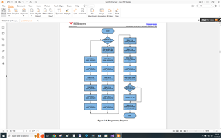

  • For problem 1, I wonder if you can offer data stream on TPS929120 RX/TX pin captured by digital analyzer?  It may help verify if sequence is correct.
    For problem 2, do you mean that with External Device address, you can successfully program EEPROM although CRC is not correct? When you write the new crc into eeprom, do you also follow program sequence?
    I attach program sequence as below,  While entering the EEPROM programming mode, the sequential command writing cannot be interrupted. Otherwise the device will not enter EEPROM programming mode successfully.

  • Please exactly follow the sequence listed in the datasheet and the sequential command writing cannot be interrupted. Otherwise the device will not enter EEPROM programming mode successfully.
    For example, after writing 09h to CONF_EEPGATE, next frame you need to write 02h to CONF_EEPGATE .
    The file you shared shows that the sequence was interrupted by other command
