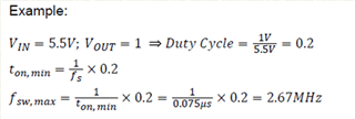

Q2.
Calculate the situation of Vin=3.63V and Vout=3.329V: VIN=3.63V, VOUT=3.329V => Duty= 3.329V/3.63V= 0.917 fsw_max=1/(ton_min)*0.917=1/(0.075us)*0.917=12.22MHz>4MHz Is it conceivable that it can be set to any value from 1 to 4MHz? And in the "Example" case, it can only be set to the range of 1~2.67MHz?
Yes that's right. With your specific conditions Fsw_ max is 12.22MHz. For this device & application conditions, Fsw can be set between 1.8-MHz to 4-MHz.
And for the example, Fsw_ max is 2.67MHz. Fsw can be set between 1.8-MHz to 2.67-MHz & not 4-MHz.

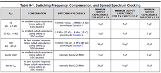

We found from the d/s:
Made the following calculations
f=2.25Mhz → T=444ns;
D= Vout/Vin =3.329/3.63 =91.71%
off time = T*(1-D) = 36.8ns (> 30 ns)
Therefore, it is considered that it has not entered 100% Duty-Cycle mode.

Hi Lillian,
In your reply you believe that Vin<Vout +1V will enter 100% Duty-Cycle mode. Therefore, in order to achieve Vout =3.329V, Vin must be >4.329V to ensure an output accuracy of 1%, right?
As per the designer of the device, it is recommended to have the 1V delta to ensure device is not in 100% mode.
The Vfb accuracy of +/-1% is valid for this condition.
This is the off-time calculated for your specific application condition.
As the datasheet says, if the minimum Toff_HS of typically 30ns reaches, skips switching cycles and enter 100% mode.
It is just the typical value, it could be in 100% before or after 30ns.
This is the reason to recommend the 1V delta between Vin & Vout to restrict the duty cycle to ensure that the device will not enter the 100% mode.
Please let me know if we need to have a call to discuss this topic and close this issue. I think this would be better.
