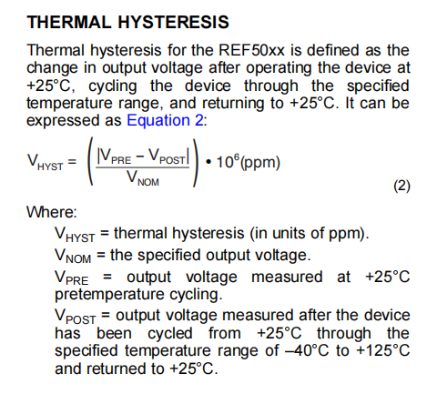

I now use the REF5040 reference and found a problem:
The device is calibrated at a constant temperature of 40°C, then shut down for one night, and then turned on the next day to keep the temperature at 40°C, and the voltage of the REF5040 becomes larger.

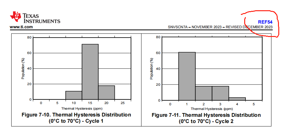

I also found the relevant content "THERMAL HYSTERESIS" thermal lag in the manual,the general meaning is that when the reference returns to the initial temperature from other temperatures, its output voltage cannot be fully restored and there will be a certain deviation. The manual only gives the formula but not the deviation range. I read the REF54xxx manual and it has a range.
What the thermal hysteresis range of the REF5040 is?
