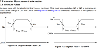

Section 8.3.4 of the November 2024 datasheet release refers to a potential risk of causing shoot-through by not adhering to a certain minimum pulse width. In addition, this minimum pulse width is dependent on many circuit parameters.

  2. Is the shoot-through risk only because of the possible EOS driver damage during non-zero current switching events? Or is there a risk of direct shoot-through due to the output stage not changing state as indicated in section 7.1, even if there is no EOS driver damage?

    The EOS driver damage caused by narrow pulses typically would not cause a shoot-through. I believe that the application note is referring to the input deglitch filter that can hold the output high. This would allow both outputs to be on if deadtime interlock function is not enabled in the application.
    Can you therefore confirm that if the deadtime is set via the external resistor, that it is not possible for the deglitch filter to cause shoot-through via a narrow pulse?
    Yes, I can confirm this. With deadtime set, there would not be instances of shoot-through caused by narrow pulses.
