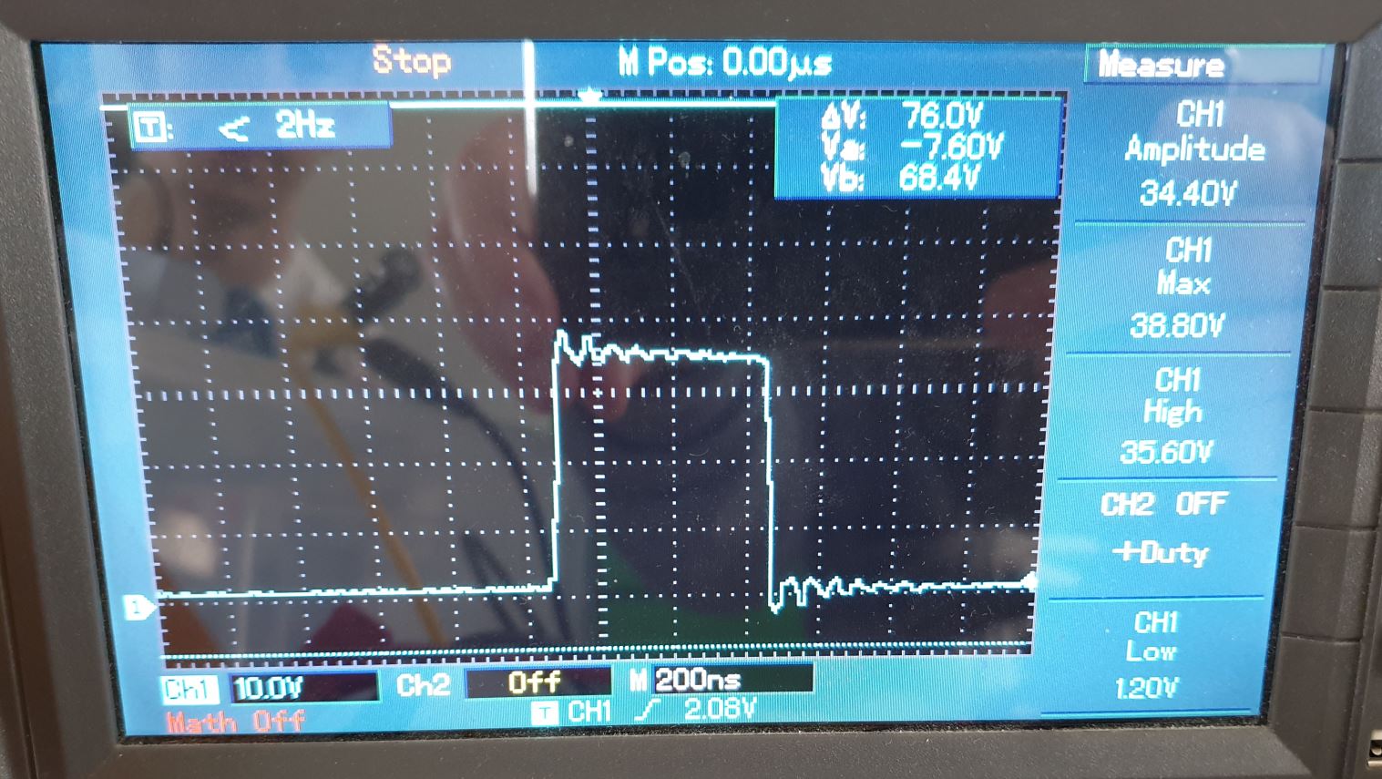

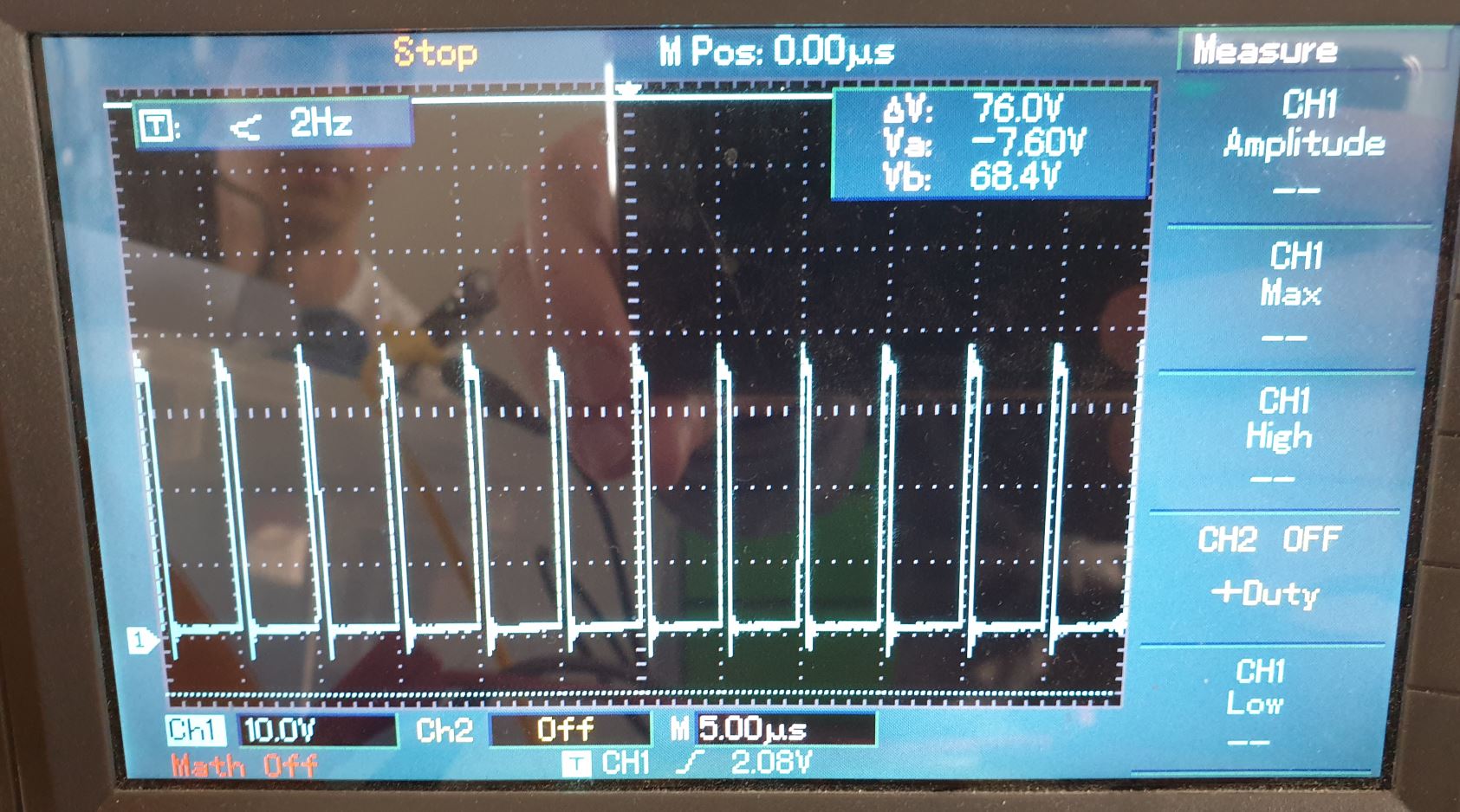

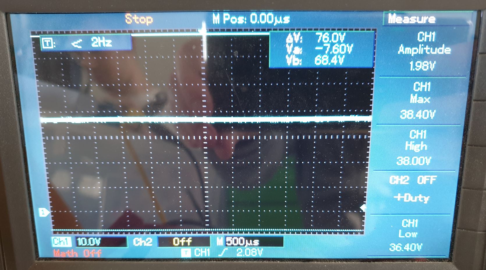

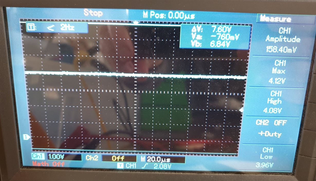

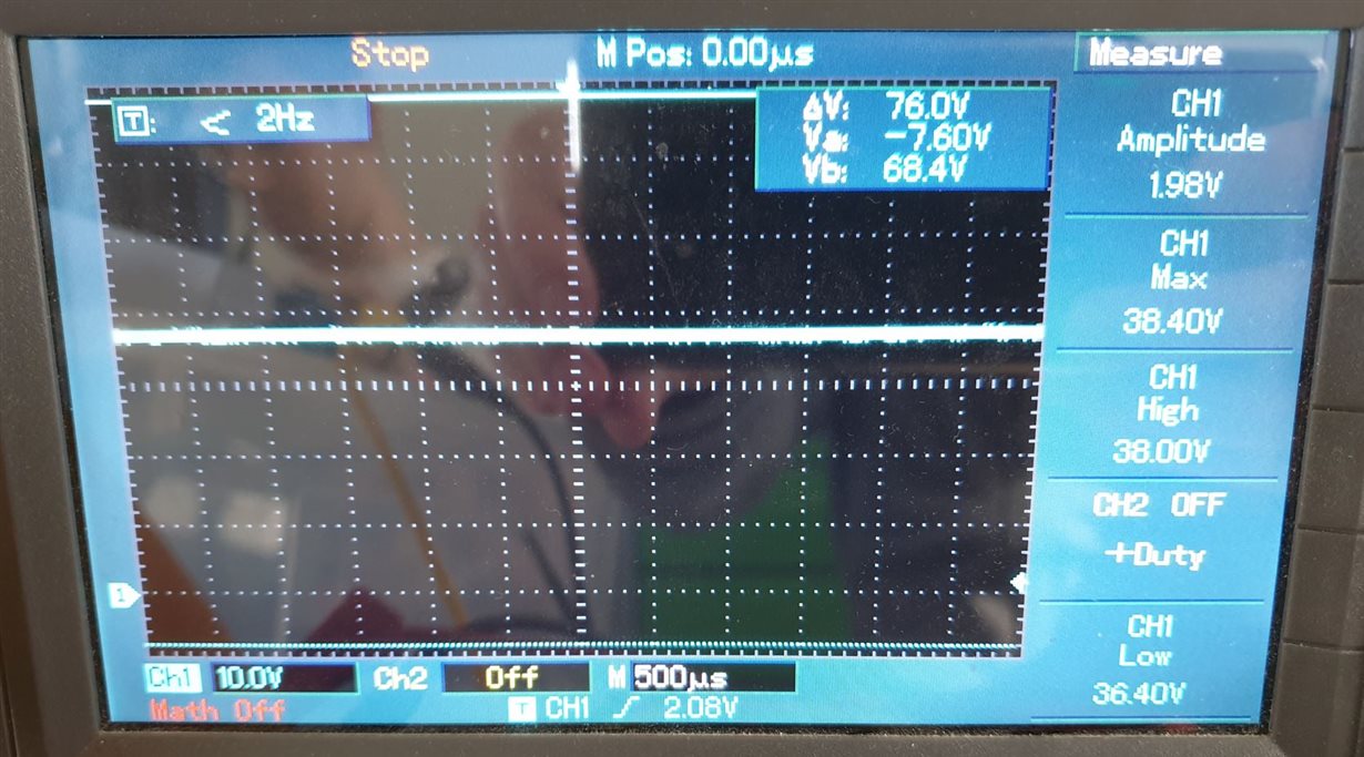

    Here are the scope pictures after a powercycle:
    SW node
    vout at startup
    Vout:
    Vin:
    SS pin

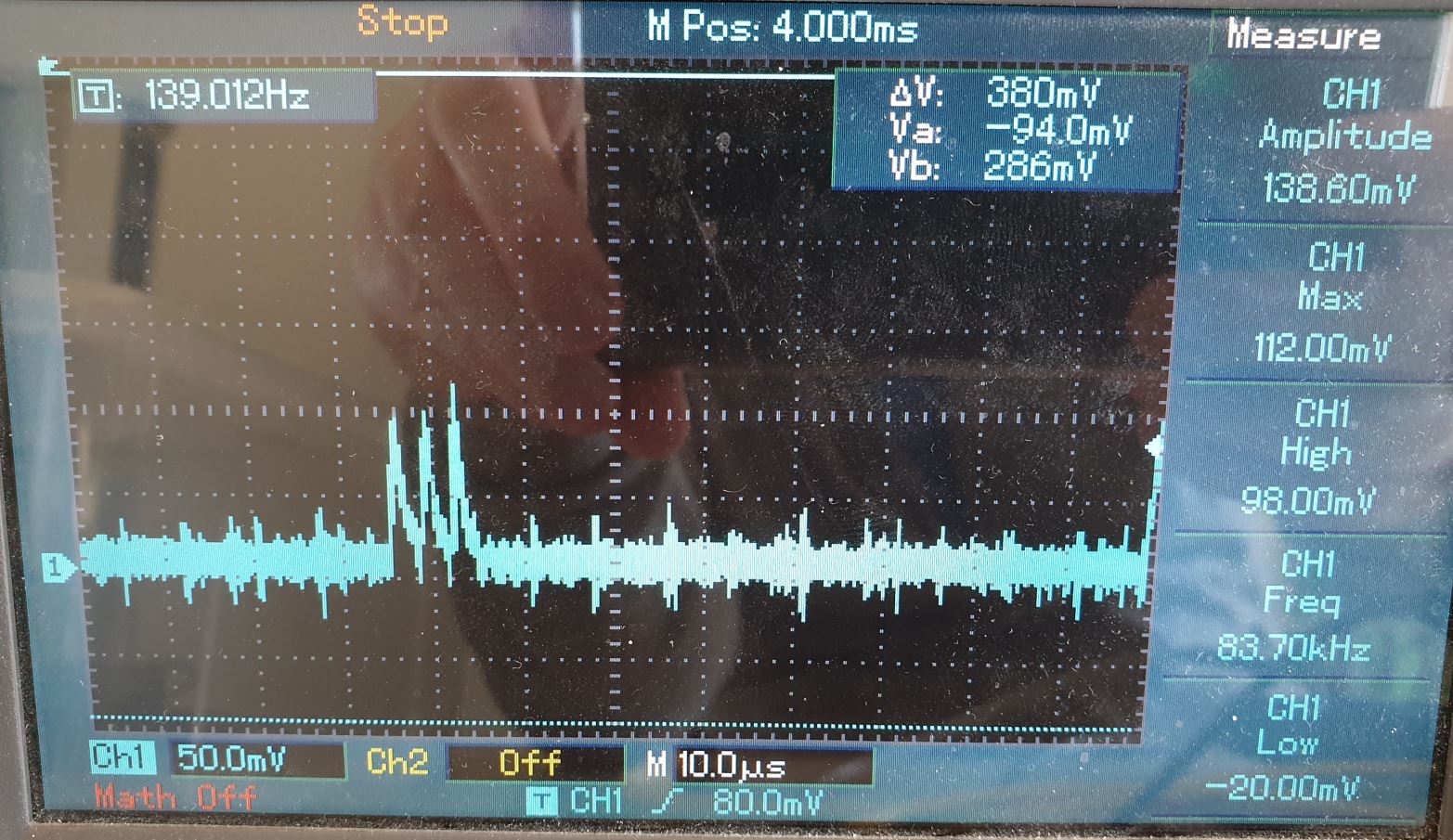

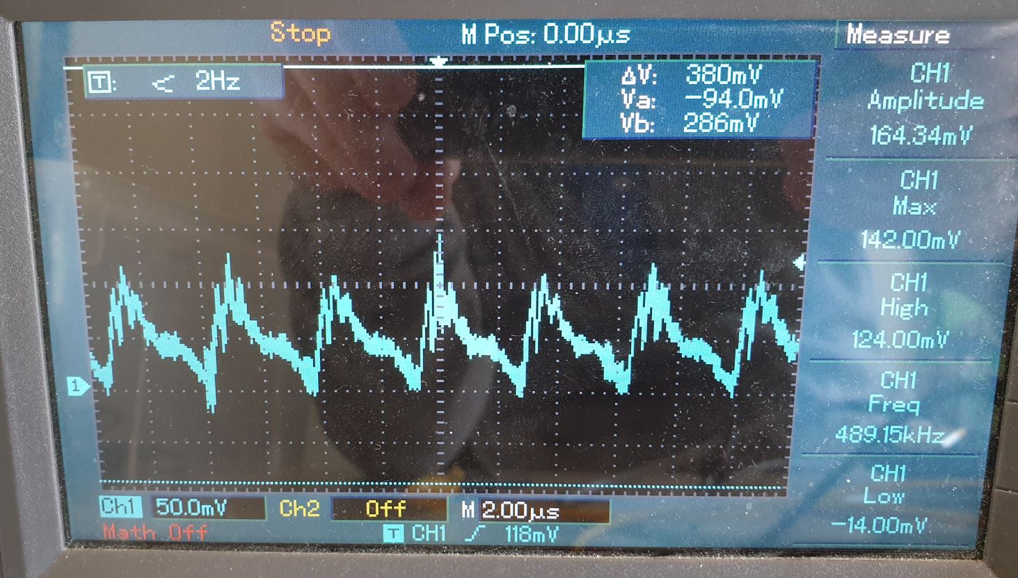

  • Hi Timothy,
    I finally could probe the inductor current over a 120mOhm resistor. You can see it in the pictures below. One with full load, the other with about 5% load.
    I have some distortion, because I had to extend the paths to the inductor.
    I looked for the residual current and found out, that we have some voltage feedback from another runinng controller. If this controller is off, the output voltage is 0.
    What can be the reason, that the LM5166 is shuting down?
  • Hi Steffen,
    My recommendation is to lift the VOUT side of the inductor and measure with a current probe to get a cleaner measurement.
    The second plot here looks like steady state operation. What is the first plot? Seems like a light-load or no-load condition.
    Tim
  •    Hi Tim,
    you are right. As I wrote   before one is with light load and the other with full load of 300mA.

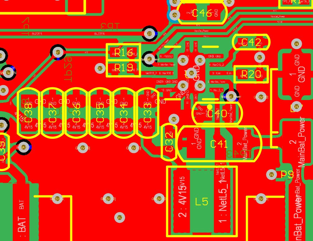

  • Hi Steffen,
    Please forward the PCB layout for review. Are the feedback resistors located close to the FB and GND pins? If not, noise pickup at FB may be an issue.
    Tim
  • Hi Tim,
    below you will find the PCB layout. R16, R19 are the FB-resistors.
  • Hi Steffen,
    You mentioned earlier that there is another running controller. This may be the issue as it affects what should be a constant ratio between VOUT and FB voltages. Note that we haven't explained the 0.36V voltage on FB if VOUT is at GND.
    Tim

  • Hi Steffen,
    Based on our offline conversation, let's ensure that the input bus is adequately damped to mitigate input resonance associated with long input lines. A high ESR electrolytic input cap is one option here.
    Tim
