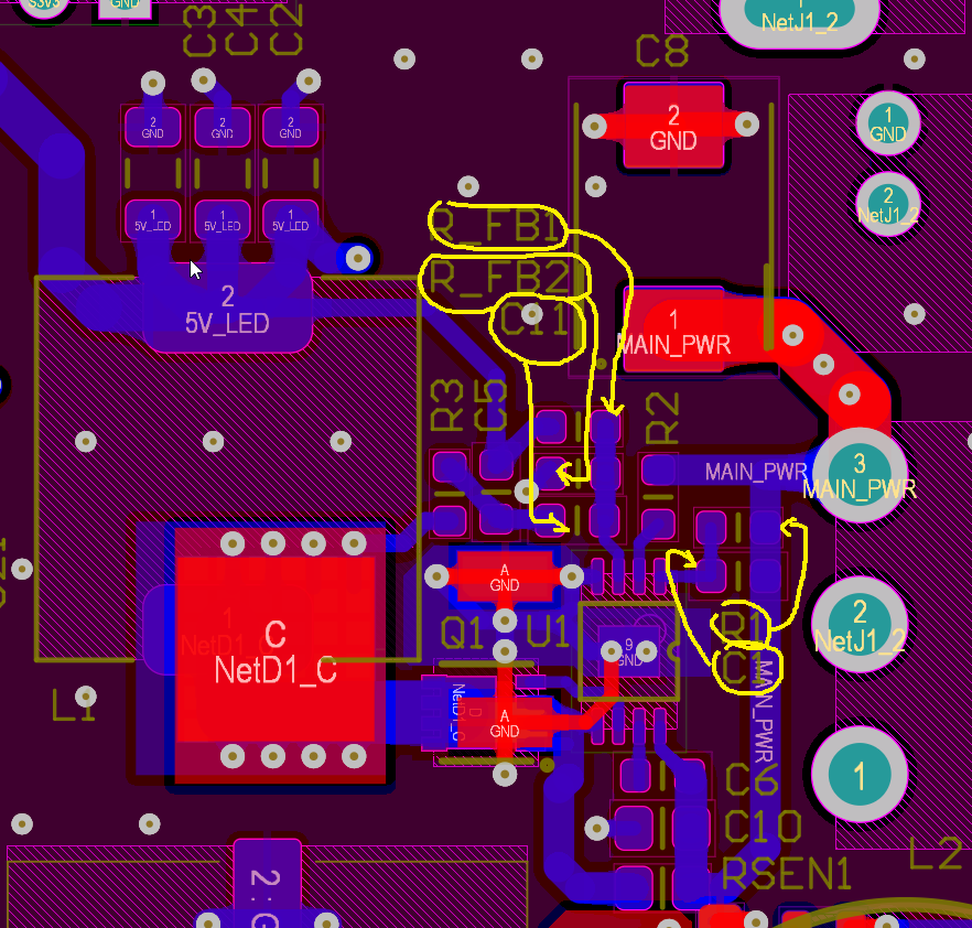

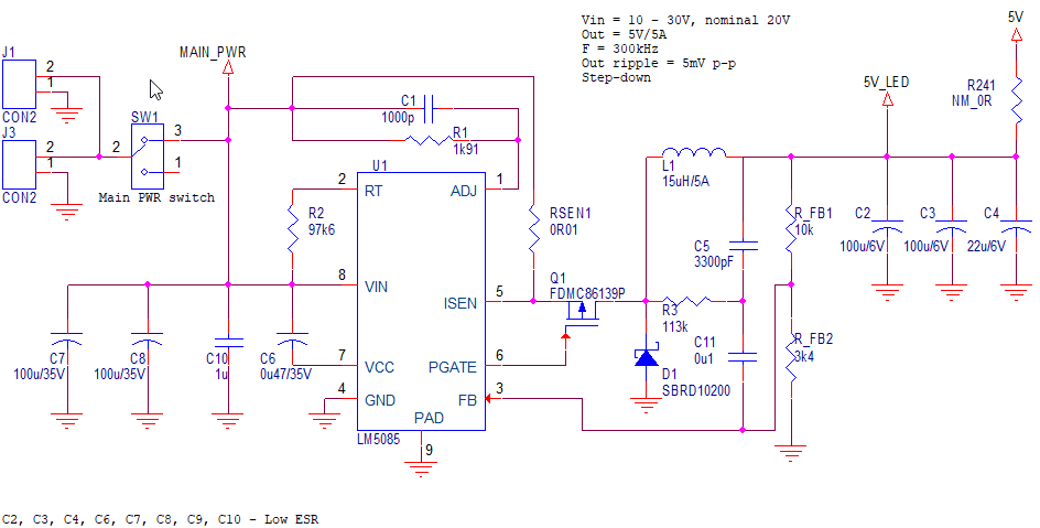

I have a big issue with step-down DC-DC converter based on LM5085.
I used design shown as typical application in datasheet, however with different components since my working assumption is a little bit different.

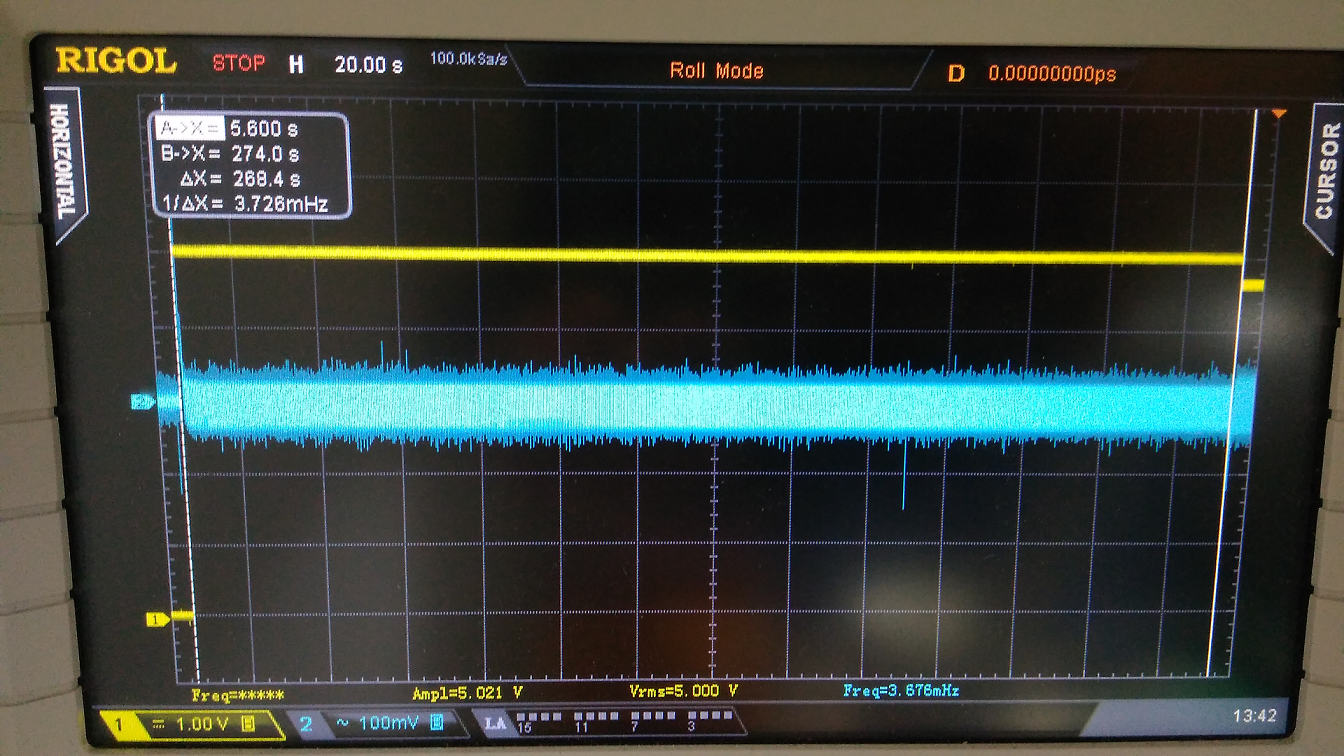

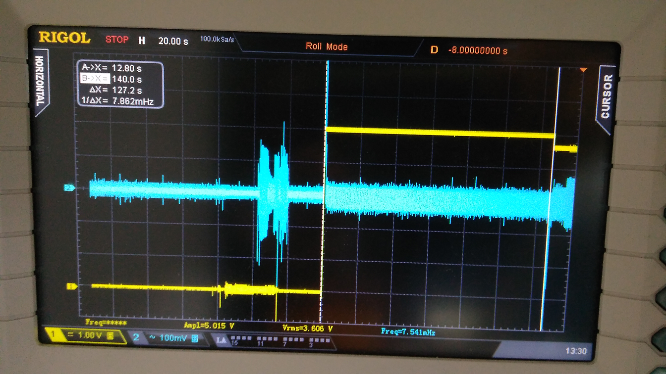

First issue, with calculated R1 (Radj) that is 1k91 I'm not able to achieve expected max current (4,5A). I had to change it to 6k2 to be able to get max current. But now, after few seconds of stable work (Vout=~5V, Iout=~4,4A) voltage drops to 4,7V and current decrease to 4A. Additionally L1 is getting hot.
Second issue is voltage ripple at the output which is about 80-100mVp-p.

When R1 was replaced by variable resistor connected with wires to the PCB then experimentally I was able to achieve expected values at the output but only for about 120-200s then voltage dropped to 4,7V and current to 4A. When I replaced variable resistor mounted as R1 by solid one with value 6k2 (with this value I was able to achieve expected output current) then output voltage and current were OK for 20-30s. After this time output voltage dropped to 4,7V and current to 4A. Oscilloscope plots for both variable and solid resistors are attached below.

    Thank you for your description of your problem as well as sharing the BOM, layout and schematic. I will forward your questions to the product expert for his feedback.

    Please forward a completed LM5085 quickstart file for you design. I noted that the SBRD10200 10A/200V diode is really high voltage based on your Vin-max of 30V. You will achieve higher efficiency and lower temperature rise with a 40V diode.
    More important, the sat current rating of the Bourns SRR1210-150M inductor is only 5.3A (and this will be lower at hot). Please check with a higher sat current rating inductor.

  • Hi Tadeusz,
    If the inductor saturates, the peak current will be much higher than expected for a given DC output current, hence why you had to increase the ILIM resistor.

    I've changed L1 to HM78D-128150MLFTR which has: inductance (parallel): 15uH, RMS current (parallel): 5.8A, saturation current (parallel) 9.1A, resistance (parallel): 0.036R and unfortunately this hasn't helped at all. With this new inductor almost all parts on the PCB are getting hot (inductor and Q1 are really hot). Previously only inductor was hot (but not so much hot as now).
    After power up output voltage and current drop two times (I've tried few times and only time after which voltage drops is different):
    Zoom to first drop (voltage dropped to about 4V8, current drops to 4,3A):
    Zoom to second drop (voltage dropped to about 4V6, current drops to 4,1A):
    DC signal is yellow, ripple output voltage is blue.
  • Hi Tadeusz,
    I noticed that channel 2 with the AC coupled output voltage (showing the ripple) is very similar to a load transient response.
    Does the FB voltage (pin 3) remain at its regulation threshold of 1.25V when the output decreases? Please send the inductor current waveform too.
    Tim
