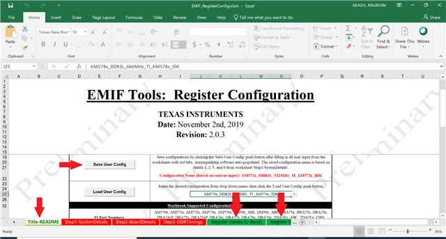

Can you guide me step by step for modifying DDR/RAM configurations on AM57x.
    The recommended way of configuring the DDR for AM57x devices is by using the EMIF tool.
    The tool is present online.
    Steps to be followed:
    1. Download the tool. It is in the form of spreadsheet.
    2. Have your DDR datasheet handy, as it will be needed to fill various parameters in the spreadsheet.
    3. You can take the reference of Application Report for AM57x, DRA7x, and TDA2x EMIF Tools, which will guide you to fill the spreadsheet step by step.
    4. Once you are done with step1, step2 and step3 in the spreadsheet, you have to click the “Save User Config” present in the first tab – Title-README - of the spreadsheet. This will auto populate the registers values in the respective tabs.
    5. You will get required Register values for U-Boot and GEL_SBL as a output of this tool.
    6. You can follow the steps mentioned in Application Report section 3.3 for configuring U-Boot.

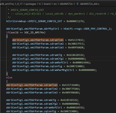

  • For updating the <pdk_root_folder>\packages\ti\board\src\<board>\<board>_ddr.c file, please keep following pointers in mind:
    • You will not get direct structure/MACROs (like gel), which you can search and update the values.
    • You have to manually update all the values at all places in the file (no top level structure like uboot).
    • If you have modified the gel file, then you would have noticed that same naming convention is followed in both EMIF tool and Gel file. But, this is not the case with the board library. You will find similar kind of naming here but it will not be a exact match with what you got from the EMIF tool. For example see the below picture :
    In this "ddr3Config1.emifDdrParam.sdramTim1" is SDRAMTIME1 and so on.
