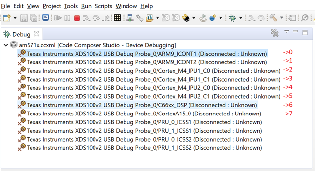

    • dslite.bat --mode load --config=<path\to\ccs\target\configuration\am571x.ccxml> -f <path\to\uniflash\root_folder>\processors\FlashWriter\idkAM571x\uart_idkAM571x_flash_programmer.out -n 7
      note - “n” represents core id. On AM571x, “7” corresponds to a15 core. You can easily get the core id by launching the respective target configuration in CCS and manually counting starting from zero.
