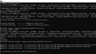

    4. Build the pdk using gmake
          C:\ti\pdk_c667x_2_0_16\packages>gmake clean -j4
          C:\ti\pdk_c667x_2_0_16\packages>gmake all -j4
    SDK build
     1. Open command prompt.
     2. Go to the install directory of processor_sdk_rtos_c667x_6_03_00_106
         >cd C:\ti\processor_sdk_rtos_c667x_6_03_00_106
    3. Run the setupenv.bat - To set up the environmental variables.
          C:\ti\processor_sdk_rtos_c667x_6_03_00_106>
    4. Build the sdk using gmake
          C:\ti\processor_sdk_rtos_c667x_6_03_00_106>gmake clean -j4
          C:\ti\processor_sdk_rtos_c667x_6_03_00_106>gmake all -j4
    Step2:
    1. In step1 , we have built the IPC demo.
    2. Please check whether the Binary files of the IPC demo are generated at the paths given below
    Binary file of Master code - master.out  C:\ti\processor_sdk_rtos_c667x_6_03_00_106\demos\image_processing\ipc\evmc6678l\master\no_instrumentation\build\image_processing_evmc6678l_master.out
    Binary file of Slave code - slave.out
    C:\ti\processor_sdk_rtos_c667x_6_03_00_106\demos\image_processing\ipc\evmc6678l\slave\no_instrumentation\build\image_processing_evmc6678l_slave.out
