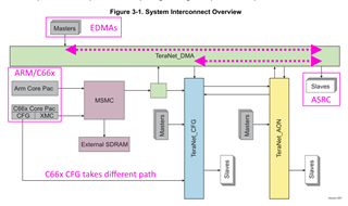

  • Hi O.H,
    Q1:
    Sorry about my TeraNet_DMA confusion. A master like ARM, C66x, or EDMA is required to initiate the data transfer from McASP to ASRC and back. Since the ASRC hangs off of the TeraNet_DMA, all data paths to/from ASRC will have to go through TeraNet_DMA. The different routes depend on which interconnect the master hangs off. Refer to below figure.
    Notice how the C66x CFG takes a different path compared with C66x XMC and ARM Core Pac.
    To explain that, refer to 6.2.1 DSP Subsystem Overview.

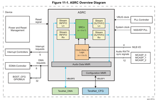

      – One 256-bit port to MSMC controller
    Compare this against Figure 11-1. ASRC Overview Diagram (color-coded below) and you'll see that the path from C66x to Configuration MMR goes through TeraNet_CFG. Whereas the path from C66x to Audio Data MMR goes through TeraNet_DMA, via MSMC with the XMC.
    In TRM, the below tables explain in a different way the difference in paths.
    Table 3-3. TeraNet_DMA Connectivity Matrix - C66X_COREPAC_0_CFG to ASRC_0_S does not take TeraNet_DMA path
    Table 3-5. TeraNet_CFG Connectivity Matrix - C66X_COREPAC_0_CFG to ASRC_0_CFG does take TeraNet_CFG path (for configuration MMR)
    What is not shown in these tables is that C66X_COREPAC_0_MDMA_MST does have a path to ASRC_0_S through TeraNet_DMA (for Audio Data MMR)
    In general, C66x has access to everything in the device. ARM also.
