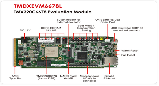

    Step-2 :
    Ensure power connections,  emulator connections between PC and EVM.
    • Connect 12V DC Power supply to Power Jack of the EVM.
    • Connect mini B type USB Cable to the USB Port of the EVM for emulator connection and the other end to the PC.
    • Connect Ethernet cable between EVM and PC.

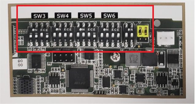

    • Ensure DIP switch settings as shown above for
    •      SW3 - 0010 ,
    •      SW4 - 1111
    •      SW5 - 1110
    •      SW6 - 1111

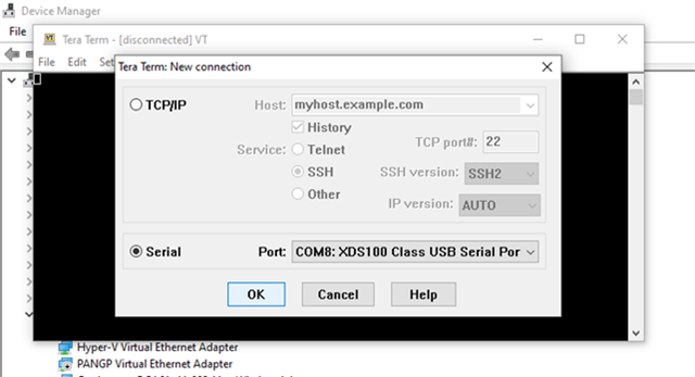

    Once the USB mini cable is connected,  recognize the “XDS100 Emulator” in the Device manager window of the PC.
    Step-5:

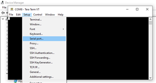

    Open Hyper Terminal or Tera Term in PC.
    Set the serial port number in which the XDS emulator is recognized in the Device manager.

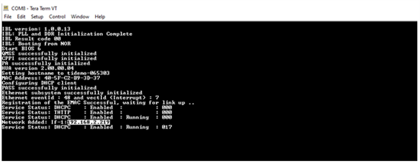

    • Reset the EVM by using Full Reset Button
    Step-7:
    • IBL gets booted and launch the HUA demo.
    • Copy the IP Address fetched by the EVM which gets displayed on the tera-term.
    • Here the IP address displayed is 192.168.2.219

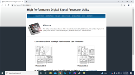

    STEP-8:
    • Feed the same IP Address, “192.168.2.219” in any Browser. It will launch the out of box demo as shown below.
    Step-9:
    • Using this demo, You can try out various diagnostics test, benchmark test, Flash test (NOR,NAND,EEPROM ) and tests for internal and external memory
    For example, LED blink test is shown in the below picture etc.
