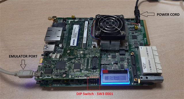

  • Connection Details:
    DIP switch settings for NOBOOT SW3- 0001

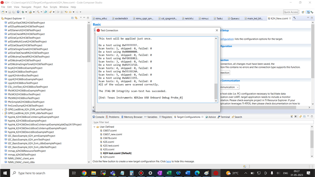

    1. Open CCS (Code composer studio), Goto "View -> Target Configuration", now "Target Configuration" window will be visible.
    2. Under "User Defined" folder, we can create new configuration which will be common for all projects.
    3. Select and Right click "User Defined" option and select "New Target Configuration" (Also we can import if you have *.ccxml files from previous projects) and save your configuration(ccxml file) in preferrd location.
    Test connection for the EVM
    1. Double click the configuration(ccxml file) and In the "Basic" tab, select the "connection" (In my case "Texas Instruments XDS2xx USB Onboard debug Probe") and select the appropriate device in "Board or Device" drop down menu.
    2. Click "Test onnection" and verify "JTAG Integrity test succeeded", to successfully connect the device.

    Output screenshot
