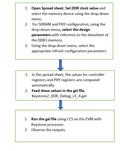

    Sequence:

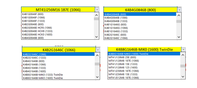

     If DDR3 memory is one among the list, follow the procedure below
    1. First watch the video and then carry out the steps given below. This video will cover up-to step- 6 .This video will cover up-to step- 6 .
    2.
    3. Open the spread sheet. (Only, the yellow colored cells are editable either by drop down menu or by typing.)
    4. Select the Appropriate DDR clock. Select the memory from the drop down menu.
    1. USING DROP DOWN MENU, Select the following design parameters according to your design requirement

    1. That’s it... We are done.
    2. Go to sheet, “Controller registers” and “PHY registers”. Now all the values are computed automatically.

    1. Use / feed these values in the debug gel file, Keystone2_DDR_Debug_v1_4.gel
    2. Run this debug gel file in the EVM and observe the outputs.

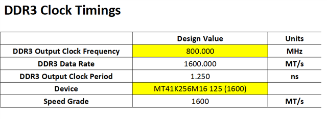

    For example: Let us take the timing parameter, “ T_RP”, the value to be filled is 13.75 ns with reference to the datasheet of the memory device for its appropriate speed grade.
    Similarly fill all the timing values.
    1. Now, go to sheet, “Design parameters” and set the Appropriate DDR clock. Select the “user defined memory” from the drop down menu.
    DDR3 Clock Timings
    Design Value
    Units
    DDR3 Output Clock Frequency
    800.000
    MHz
    DDR3 Data Rate
    1600.000
    MT/s
    DDR3 Output Clock Period
    1.250
    ns
    Device
    User Defined
    Speed Grade
    1333
    MT/s
