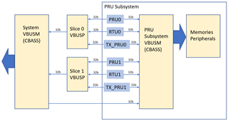

    PRU Bus Structure: PRU-ICSS, PRU-SS
    The PRU subsystem has an internal CBASS (also called VBUSM). Each PRU core has a direct connection to the internal CBASS, and to the system CBASS. Accesses to the external CBASS are totally separate from accesses to the internal CBASS. That means that reads or writes over the internal CBASS are unaffected by reads or writes over the external CBASS.
    VBUSM interconnects are "fully switched". That means that multiple cores can use the CBASS simultaneously, as long as the cores are accessing different endpoints. e.g., PRU0 can access DRAM at the same time that PRU1 is accessing the PRU's hardware UART. An endpoint can be a peripheral, or a memory. Separate memories act as separate endpoints (e.g., one core can access DMEM0, one core can access DMEM1, and another core could access SRAM simultaneously).
    PRU Bus Structure: PRU_ICSSG
    In addition to the CBASS interfaces on PRU-ICSS, the PRU_ICSSG has a VBUSP between each ICSSG slice and the external CBASS. VBUSP is different from VBUSM, because VBUSP can only be used by one core at a time.

    Arbitration to the external CBASS (PRU_ICSSG only)
    PRU-ICSS & PRU-SS cores will not experience arbitration delay when trying to access the external system CBASS.
    Each PRU_ICSSG slice has a choke point where the PRU, RTU, and TX_PRU all connect to the same VBUSP, which connects to the external CBASS. Thus, if one core in a slice is reading or writing to the external CBASS through the VBUSP, the other cores in the slice cannot access the external CBASS until the VBUSP becomes available. The interface to the external CBASS is 4 Bytes wide, so the math to calculate arbitration delays to the external CBASS is the same as calculating arbitration delays to the internal CBASS. See the "internal CBASS" discussion of arbitration delay for how to calculate the arbitration delay for an atomic read or write.
    If multiple PRU_ICSSG cores try to access the external CBASS at exactly the same clock cycle, arbitration priority is: TX_PRU first, then PRU, then RTU.
    There is NOT a choke point across slices. e.g., if ICSSG1_PRU0 is using the external CBASS, then ICSSG1_PRU1 is NOT affected by arbitration delay since it is in a separate slice.
