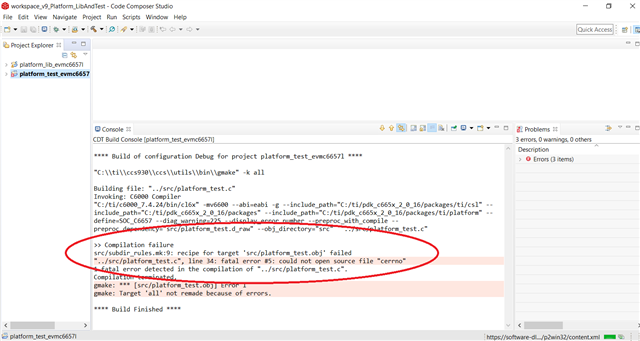

How to solve the Cerrno Error in the Platform test example of PDK in processor SDK 6.3 ?
  • HI,
    Question : How to solve the Cerrno Error in the Platform test example of PDK in processor SDK 6.3 ?
    Solution:
    While building Platform lib / test of PDK in Processor SDK 6.3, if received CSL errors, Please do the following steps:
    1. Right click and go to project properties
    2. Build options --> C6000 compiler --> Include option--> #include search path  Add path --> "${CG_TOOL_ROOT}/include"
    3. Apply and close.
    4. Build again.

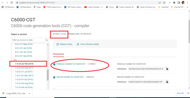

    And also please install  " C6000-CGT - C6000 code generation tools (CGT) - compiler" from the link
    https://www.ti.com/tool/download/C6000-CGT/7.4.24
    Make sure you install in the path: C:\ti
