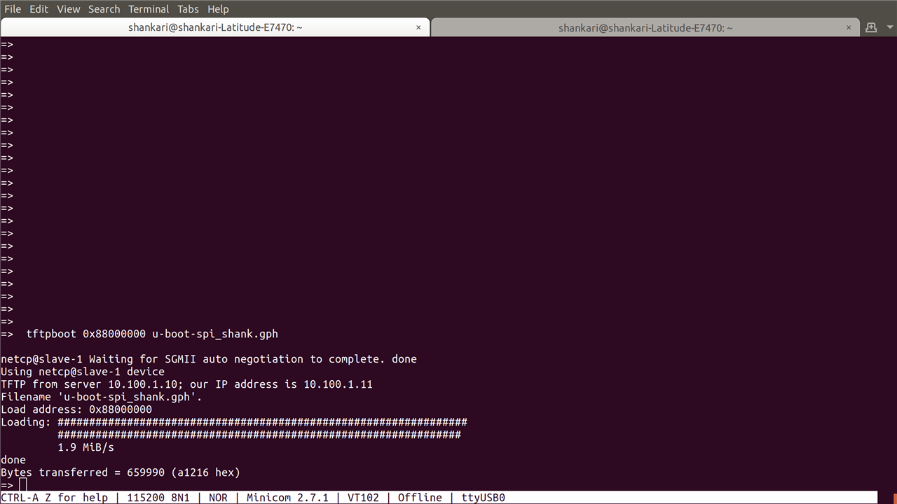

    4. Issue tftpboot command
    K2E EVM # tftpboot 0x88000000 u-boot-spi_shank.gph
    Using K2E_EMAC1 device
    Please get the size of the u-boot and change the offset accordingly.
    For example, the size of the u-boot image size is 0xa1216 and for spi flashing, the size used approximately is  0x100000 ( adding some buffer memory and rounded off the value. These adding buffer and rounding off is not necessary for SPI-flash. You can use the size, 0Xa1216, directly.
    May be for NAND with ECC, it might be meaning ful.

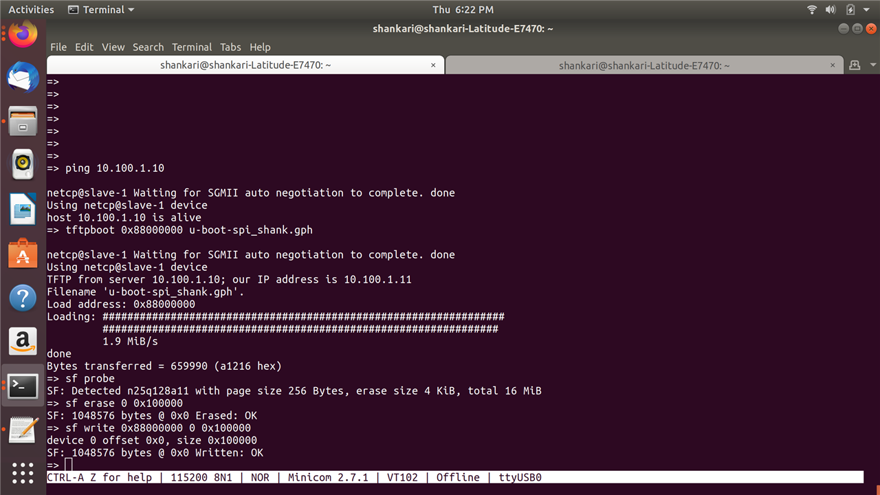

    5 Flashing uboot into SPI:
    K2E EVM # sf probe
    SF: Detected N25Q128A with page size 64 KiB, total 16 MiB
    (Offset depends on u-boot image size )
    K2E EVM # sf erase 0 0x100000
    K2E EVM # sf write 0x88000000 0 0x100000
    Please have a look at the snapshot for each flashing steps.
    DIP SWITCH setting
    SW1 : 0 0 1 0
    Press powerON reset button
    The newly built u-boot will get booted from the SPI flash
    Please verify the Date and timestamp of the u-boot built with the output messages from the device-terminal.
    For example, I built the u-boot on 14 May 2022 , and here it shows the same date, 14 May 2022
