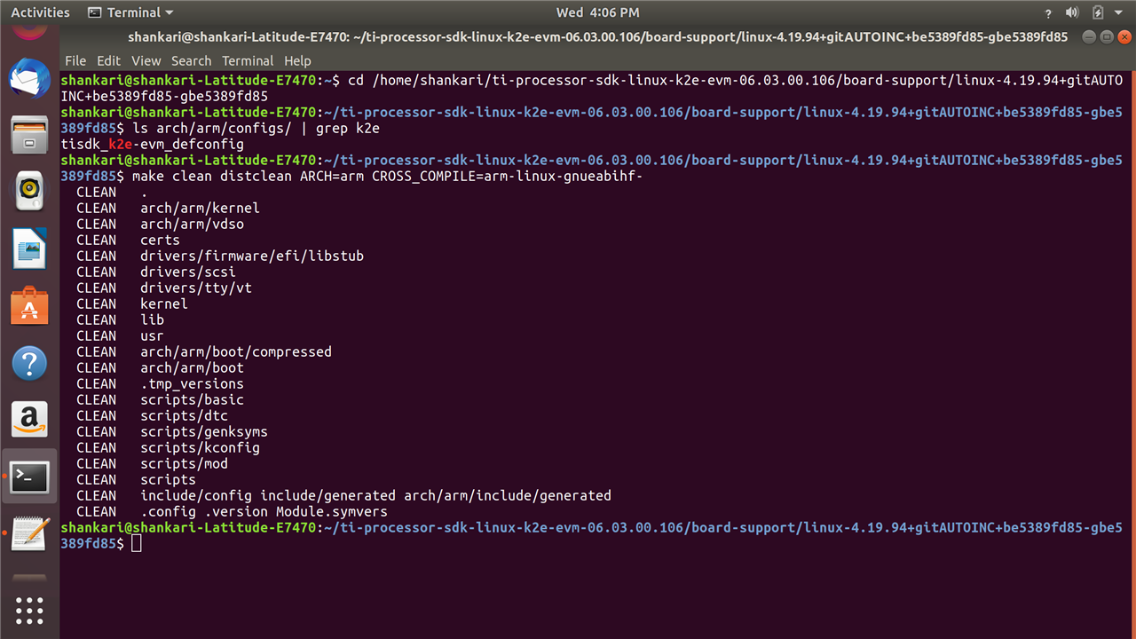

1. Go to the directory of linux from the processor sdk 6.3 package
cd ~/ti-processor-sdk-linux-k2e-evm-06.03.00.106/board-support/linux-4.19.94+gitAUTOINC+be5389fd85-gbe5389fd85
2. Execute dist-clean command
make clean distclean ARCH=arm CROSS_COMPILE=arm-linux-gnueabihf-

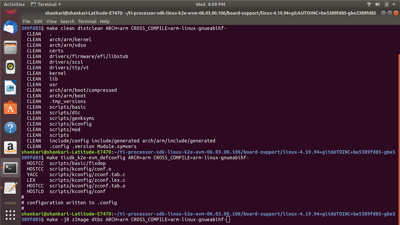

3. find defconfig for k2e board:
Note: The def-config file should match your evm.
That's why we used "ls arch/arm/configs/ | grep k2e" to check whether the "tisdk_k2e-evm_defconfig" matches with the one we are using in the next command
make tisdk_k2e-evm_defconfig ARCH=arm CROSS_COMPILE=arm-linux-gnueabihf-

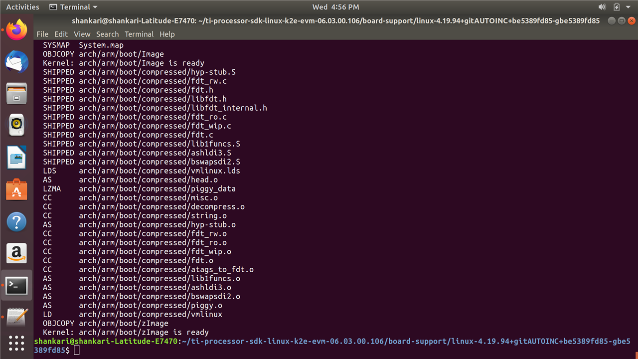

4. Building Linux & dtbs
Note: The below command will build the linux image ( zImage ) and the "dtb".
make -j8 zImage dtbs ARCH=arm CROSS_COMPILE=arm-linux-gnueabihf-
5. Check the timestamp to verify the build was done successfully.
ls -al ./arch/arm/boot/dts/keystone-k2e-evm.dtb
ls -al ./arch/arm/boot/zImage
