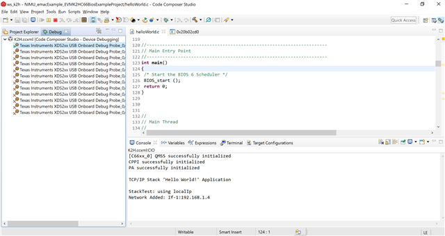

        1. Static IP configuration:
          // Local IP and gateway IP can be modified to our requirement
          char *HostName    = "tidsp";
          char *LocalIPAddr = "192.168.1.4";
          char *LocalIPMask = "255.255.255.0";    // Not used when using DHCP
          char *GatewayIP   = "192.168.1.1";    // Not used when using DHCP
          char *DomainName  = "demo.net";         // Not used when using DHCP
          char *DNSServer   = "0.0.0.0";          // Used when set to anything but zero
          // Main Thread
          int StackTest()
              // If the IP address is specified, manually configure IP and Gateway
              #if defined(_SCBP6618X_) || defined (DEVICE_C6678) || defined(_EVMTCI6614_) || defined(DEVICE_K2H) || defined(DEVICE_K2K) || defined(DEVICE_K2L) || defined(DEVICE_K2E)
              /* SCBP6618x, EVMTCI6614, EVMK2H, EVMK2K always uses DHCP */
              if (1) // set it as 1 for Manual IP configuration
                  //Manual IP configuration code
              else
                  //DHCP IP configuration code
          1. Output for static IP in DSP core
          2. Verification
          3. Output for static IP in the ARM core
