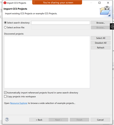

    Now Import the CCS project into CCS and go on
    1. To Import the project goto File -> Import -> "CCS projects" in "C/C++" -> Browse "Select Search-directory". make sure to uncheck the "Copy Projects into Workspace" (This is to avoid compilation errors only If TI-RTOS SDK was installed in a different location than "C:\ti\").
    2. Now, we have DSP example project ("NIMU_emacExample_EVMk2eC66BiosExampleProject") and ARM example project ("NIMU_emacExample_EVMk2e_armBiosExampleProject") (Do not open ARM and DSP examples at same time, CCS will throw project out-of-sync error dialog).

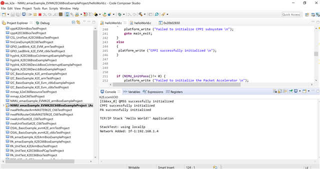

        1. Static IP configuration:
          // Local IP and gateway IP can be modified to our requirement
          char *HostName    = "tidsp";
          char *LocalIPAddr = "192.168.1.4";
          char *LocalIPMask = "255.255.255.0";    // Not used when using DHCP
          char *GatewayIP   = "192.168.1.1";    // Not used when using DHCP
          char *DomainName  = "demo.net";         // Not used when using DHCP
          char *DNSServer   = "0.0.0.0";          // Used when set to anything but zero
          // Main Thread
          int StackTest()
              // If the IP address is specified, manually configure IP and Gateway
              #if defined(_SCBP6618X_) || defined (DEVICE_C6678) || defined(_EVMTCI6614_) || defined(DEVICE_K2H) || defined(DEVICE_K2K) || defined(DEVICE_K2L) || defined(DEVICE_K2E)
              /* SCBP6618x, EVMTCI6614, EVMK2H, EVMK2K always uses DHCP */
              if (1) // set it as 1 for Manual IP configuration
                  //Manual IP configuration code
              else
                  //DHCP IP configuration code

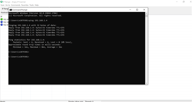

          1. Output for static IP in DSP core
          2. Verification

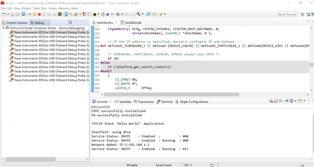

        2. DHCP configuration:
          // Main Thread
          int StackTest()
              if (0) // set it as 0 for DHCP IP configuration
              else

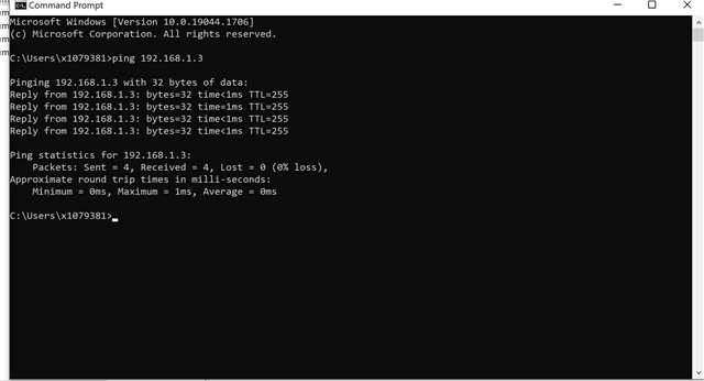

          1. Output for DHCP for DSP core
          2. Verification
          3. Output for DHCP in the ARM core
          4. Unlike C665x and C667x examples, Telnet and HTTP service were not included in the source code. So, TCP Ports 23 and 80 remain closed and only verification can be done using the Ping utility.
