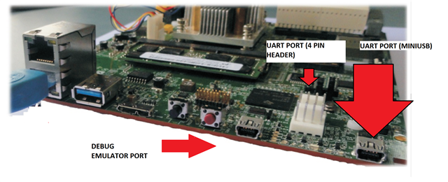

    2. For Hardware connections,
      1. we can connect through the RS232Serial cable(with 4 PIN header) received along with EVM to COM1 (mentioned in EVM) and through Mini USB connecting through J1 (Other mini USB port (J3) used by Onboard Debug Emulator).
      2. There will be two mini USB ports available for UART in the "Device Manager" section in "Windows OS" (CP2105 chipset, refer to device manager image for reference)
        1. The Port with the lowest number is the UART port.
        2. The Port with the highest number is BMC port.
      3. UART configuration used in these projects were "8N1"(Data Bit = 8, Parity = None and Stop bit = 1) and baud rate "115200".

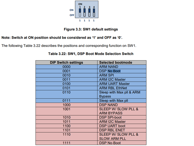

      4. EVM should be kept in "No Boot" mode and the switch settings are shown below.

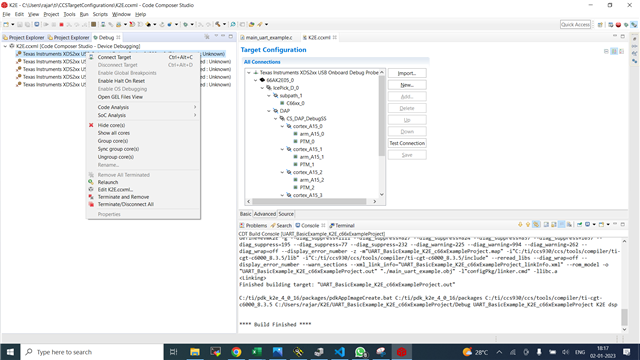

    3. For Connecting K2E EVM with CCS, Kindly refer to these links.
      1. https://e2e.ti.com/support/processors-group/processors/f/processors-forum/1062598/faq-tms320c6678-how-to-load-and-run-the-gel-file-on-c6678-evm
      2. https://e2e.ti.com/support/processors-group/processors/f/processors-forum/1062584/faq-tms320c6678-how-to-create-target-configuration-and-do-test-connection-on-c6678-evm

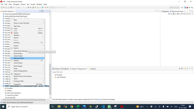

    4. To build the project, Select the project and right-click to select "Rebuild the Project". Check for compilation errors and get the "Build finished successfully" message.
    5. To run the project, Run the "K2E" target configuration and load the binary in the respective core.

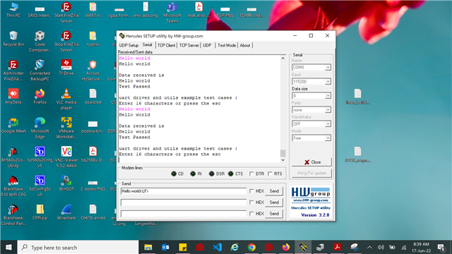

      4. To view output use any of the Serial port terminals like "Putty", "Teraterm" or "Hercules HW".
