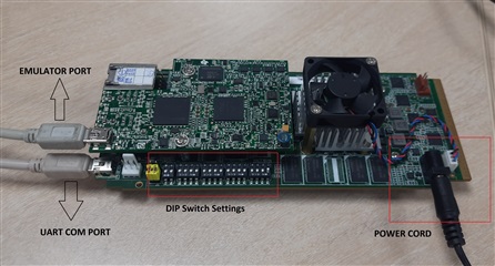

    2. For Hardware connections,
      1. we can connect through the RS232 Serial cable(with 3 PIN header) received along with EVM to COM1 (mentioned in EVM) and through Mini USB connecting through USB1 (Other mini USB port (J1) used by Onboard Debug Emulator).
      2. Look for "XDS100 Class USB Serial Port" mini USB port in the "Device Manager" section in "Windows OS".The Port with the lowest number is the UART port.
      3. DIP Switch settings for "NO BOOT Mode" "SW3- 0111 SW4- 1111 SW5-1111 SW6-1111"
        1. UART configuration used in these projects were "8N1"(Data Bit = 8, Parity = None and Stop bit = 1) and baud rate "115200".
