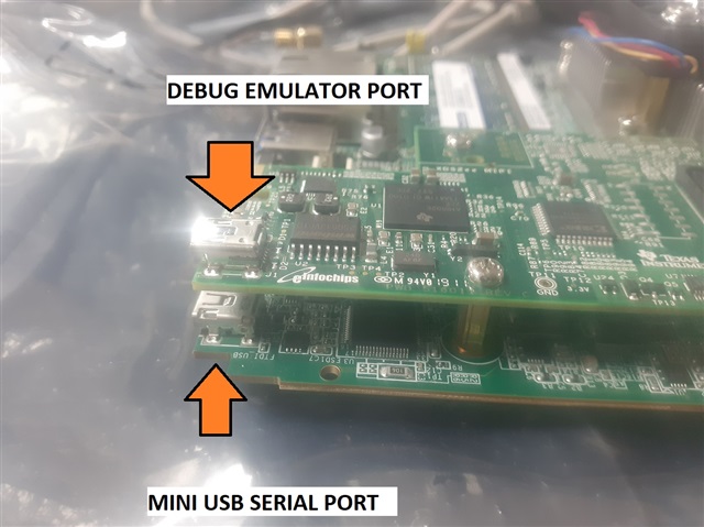

    2. For Hardware connections,
      1. we can connect through RS232Serial cable(with 4 PIN header) received along with EVM to COM1 (mentioned in EVM) and through Mini USB connecting through J1 (Other mini USB port (J3) used by Onboard Debug Emulator).
      2. There will be two mini USB ports available for UART in the "Device Manager" section in "Windows OS" (CP2105 chipset, refer to device manager image for reference)
        1. The Port with the lowest number is the UART port.
        2. The Port with the highest number is BMC port.
      3. UART configuration used in these projects were "8N1"(Data Bit = 8, Parity = None and Stop bit = 1) and baud rate "115200".
