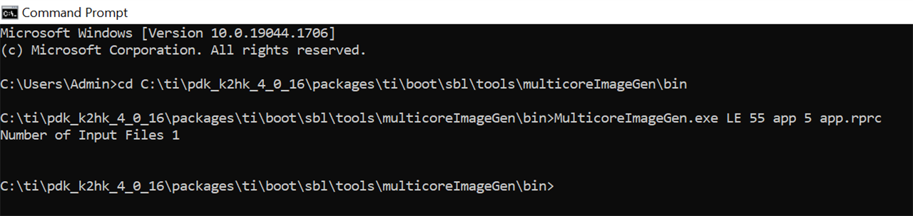

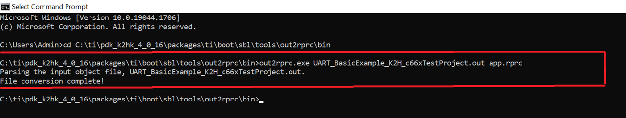

    3. In command line execute the out2rprc to convert the .out into the rprc format
          C:\ti\pdk_k2hk_4_0_16\packages\ti\boot\sbl\tools\out2rprc\bin>out2rprc.exe UART_BasicExample_K2H_c66xTestProject.out app.rprc
    4. Copy the app.rprc from path --- C:\ti\pdk_k2hk_4_0_16\packages\ti\boot\sbl\tools\out2rprc\bin --- into the  path C:\ti\pdk_k2hk_4_0_16\packages\ti\boot\sbl\tools\multicoreImageGen\bin
    5.  In command line execute the MulticoreImageGen.exe to convert the app.rprc  into the bootable file format
          C:\Users\Admin>cd C:\ti\pdk_k2hk_4_0_16\packages\ti\boot\sbl\tools\multicoreImageGen\bin
          C:\ti\pdk_k2hk_4_0_16\packages\ti\boot\sbl\tools\multicoreImageGen\bin>MulticoreImageGen.exe LE 55 app 5 app.rprc
    This step will generate the bootable app

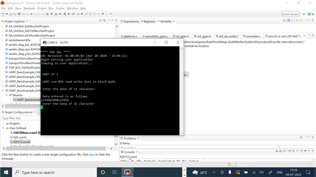

    12. Power off and put the DIP switch settings to SW1 -- 0010 -- ARM-SPI
          ----> MLO -- SBL will run on ARM, initialization will happen
          ----> It jumps to the uart app and runs on DSP.
