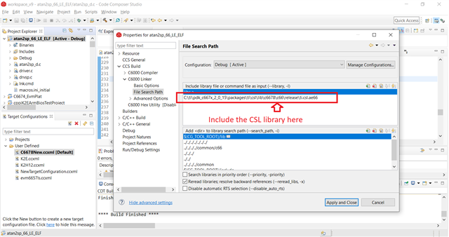

    Type 2: For other Mathlib package which doesnot enclose the CSL library.
    Pre-requisite
    Download and install "PROCESSOR-SDK-RTOS-C667x  06_03_00_106"
    from https://software-dl.ti.com/processor-sdk-rtos/esd/C667x/latest/index_FDS.html
    ( Please install the SDK in the recommended path: C:\ti\)
    This will include the CSL library.
     utilize the "TSCH" to calculate the cycles taken for the function, "atan2sp_v"
    Steps:
    In the file, atan2sp_d.c, do the following.
    Step 1:
    1. extern void  CSL_tscEnable(void); // This function is part of CSL library. We have to include  library, "ti.csl.ae66" located in the C:\ti\pdk_c667x_2_0_15\packages\ti\csl\lib\c6678\c66\release\ti.csl.ae66 in the project configuration. ( Look at the snapshot below )
    Step 2:

    Step 4:
    /* Enable the time stamp counter. */
    CSL_tscEnable();
    StartTime = utilReadTime32();
    atan2sp_v (a_sc, b_sc, output[MTH_FCN_VEC], NUM_SC_INPUTS*NUM_SC_INPUTS);
    EndTime = utilReadTime32();
    Total_cycle_ticks = EndTime-StartTime;
    printf("StartTime = %d \n", StartTime);
    printf("EndTime = %d \n", EndTime);
    printf("Total_cycle_ticks = %d \n", Total_cycle_ticks);

    Time tick calculation , you can use according to the number of Total_cycle_ticks, you get......
    Step 5:
    Total no of CPU cycles =    cycles
    DSP core frequency = 1000 MHz
    Time = 1 / Freq ( General formula )
              = 1 / 1000 MHz ( DSP core frequency )
              = 0.001 us ( Micro seconds)
    1000000000 cycles = 1 sec
    =>32149501  cycles =  0.032 sec
    -----------------> here we receive Total_cycle_ticks = 857 ===> ( (1/1000000000) * 857 = 0.000000857 seconds )
    snapshot to include the CSL library in the build configuration:
    Shankari G
