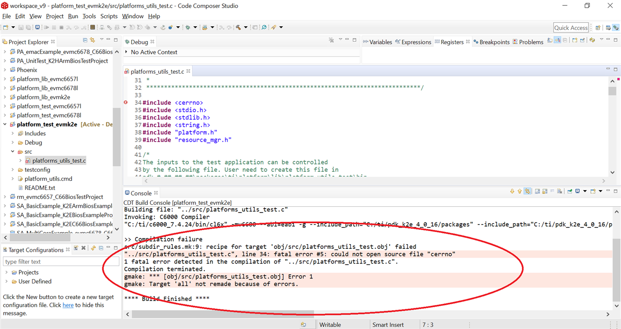

    Error 1:
    Solution

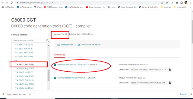

    1. Please download install  " C6000-CGT - C6000 code generation tools (CGT) - compiler" from the link
    https://www.ti.com/tool/download/C6000-CGT/7.4.24
    Make sure you install in the path: C:\ti
    2. While building Platform lib / test of PDK in Processor SDK 6.3, if received CSL errors, Please do the following steps:
    1. Right click and go to project properties
    2. Build options --> C6000 compiler --> Include option--> #include search path  Add path --> "${CG_TOOL_ROOT}/include" or "C:\ti\c6000_7.4.24\include"
    3. Apply and close.
    4. Build again.

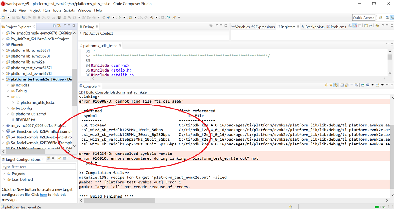

    ERROR no: 2
    Solution :

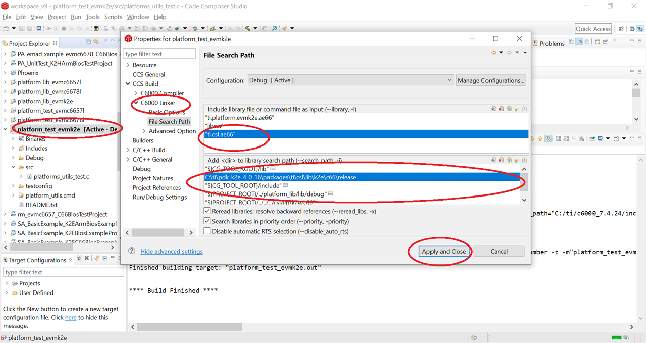

    2. Build options --> C6000 Linker--> File search path --> Add path --> "C:\ti\pdk_k2e_4_0_16\packages\ti\csl\lib\k2e\c66\release"
    (Make sure the CSL library is present.)
    3. Apply and close.
    4. Build again.
