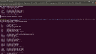

    4. Building u-boot: Goto "{SDK_FOLDER}/board-support/uboot-{VERSION}/" folder and give below command
      make distclean ARCH=arm CROSS_COMPILE=arm-linux-gnueabihf-
      make k2g_evm_config ARCH=arm CROSS_COMPILE=arm-linux-gnueabihf-
      make -j8 all ARCH=arm CROSS_COMPILE=arm-linux-gnueabihf-
      make u-boot-spi.gph ARCH=arm CROSS_COMPILE=arm-linux-gnueabihf-
    Screenshots are attached for the above commands -
    For Step 4:
