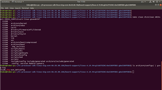

    4. Building Linux: Goto "{SDK_FOLDER}/board-support/linux-{VERSION}/" folder and give below command
      make clean distclean ARCH=arm CROSS_COMPILE=arm-linux-gnueabihf-
      ls arch/arm/configs/ | grep k2g
      make tisdk_k2g-evm_defconfig ARCH=arm CROSS_COMPILE=arm-linux-gnueabihf-

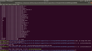

      make -j8 zImage dtbs ARCH=arm CROSS_COMPILE=arm-linux-gnueabihf-
      ls -al ./arch/arm/boot/dts/keystone-k2g-evm.dtb
      ls -al ./arch/arm/boot/zImage
    5. After successful compilation, inside "k2g_evm" directory "zImage" and "keystone-k2g-evm.dtb" file will be present.
    Screenshots are attached for the above commands -
    For Step 4:
