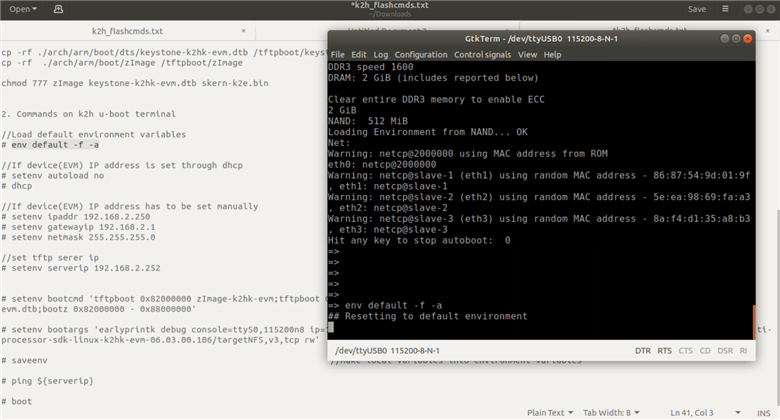

    1. Connect through "Serial terminal" with the following serial settings
      1. Baud rate: 115200
      2. Data bit: 8
      3. Stop bit: 1
      4. Parity: None
      5. Flow control: None
    2. And, now On the U-boot terminal, give the following commands sequentially in the mentioned order (Also give commands either DHCP or static IP, do not give both commands)
      //Load default environment variables
      # env default -f -a

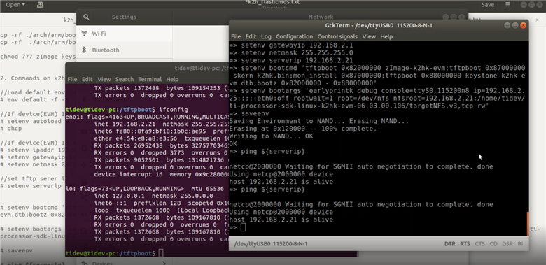

      # setenv ipaddr 192.168.2.250
      # setenv gatewayip 192.168.2.1
      # setenv netmask 255.255.255.0
      //set tftp serer ip
      # setenv serverip 192.168.2.252

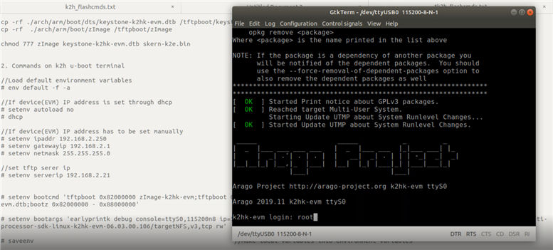

      # setenv bootcmd 'tftpboot 0x82000000 zImage-k2hk-evm;tftpboot 0x87000000 skern-k2hk.bin;mon_install 0x87000000;tftpboot 0x88000000 keystone-k2hk-evm.dtb;bootz 0x82000000 - 0x88000000'
      # setenv bootargs 'earlyprintk debug console=ttyS0,115200n8 ip=192.168.2.25:::::eth0:off rootwait=1 root=/dev/nfs nfsroot=192.168.2.21:/home/tidev/ti-processor-sdk-linux-k2hk-evm-06.03.00.106/targetNFS,v3,tcp rw'
      # saveenv							//make local variables into environment variables
      # ping ${serverip}
      # boot
    3. The following screenshot demonstrates the case,
