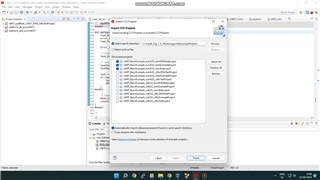

    Now, Import the CCS project into CCS and go on
    1. To Import the project goto File -> Import -> "CCS projects" in "C/C++" -> Browse "Select Search-directory". make sure to uncheck the "Copy Projects into Workspace" (This is to avoid compilation errors only If TI-RTOS SDK was installed in a different location than "C:\ti\").
      1. we have the following ARM example projects
        1. UART_BasicExample_K2G_armDMATestProject,
        2. UART_BasicExample_K2G_armExampleProject,
        3. UART_BasicExample_K2G_armTestProject.

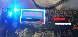

    2. For Hardware connections,
      1.
      2.  EVM DIP Switch settings, SW3 : 0 0 0 0
      3. We can connect through Mini USB connecting through J1 (Other mini USB port (J3) used by Onboard Debug Emulator).

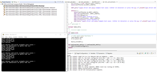

    3. After the target connection is successful, load the UART arm project into the ARM core of K2G
    1. "UART_BasicExample_K2G_armExampleProject" prints 16 character string terminated by return ("Enter")
    2. UART_BasicExample_K2G_armTestProject runs 21 test cases, if a test case is failed it exits the program.
    3. UART_BasicExample_K2G_armDMATestProject runs the 21 DMA test cases,  if a test case is failed it exits the program.
