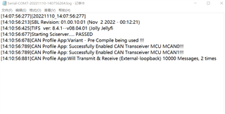

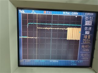

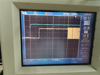

Through tests, we’ve found that it takes TDA4 3.38s to send the first frame of message from power-on. As shown in Figure 1, the software start-up time is 2.6s, and the hardware start-up time is 780ms. The oscilloscope measures the TX end of the CAN transceiver of the MCU end. The SD start-up mode is used.
Our customer cannot accept this time, and the customer requires this time be 500ms. Is it because of the startup mode? How can I start the MAU’s app from EMMC?
The app used is the can_profile program in the mcu demo. The log is shown in Figure 4.
    Can you explain your bootflow here? I see you are using SD card which will definitely consume a lot of time in initialization as compared to OSPI which is what TI recommends for early CAN response.
    Also, I assume this is running on the MCU R5F, can you confirm?
