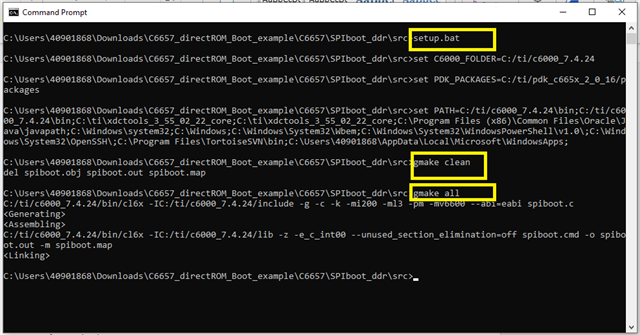

    Step 1:
    Open command prompt
    Go to path "C:\ti\pdk_c665x_2_0_16\packages"
    Run the "pdksetupenv.bat"
    Setup C6000 compiler path in the file "setup.bat" and copy into the src folder and run the "setup.bat" file from windows command line.
    • set C6000_FOLDER=C:/ti/c6000_7.4.24
      set PDK_PACKAGES=C:/ti/pdk_c665x_2_0_16/packages
      set PATH=%C6000_FOLDER%\bin;%PATH%
    Step2: Change directory to src and build the application binary:
    • gmake clean
    • gmake all
    • Note: It requires gmake in the Windows

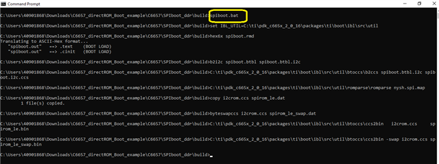

    Step3: Copy the spiboot.out to build folder - "C6657_directROM_Boot_example\C6657\SPIboot_ddr\build"
    Step4: Set IBL_UTIL path in the spiboot.bat file to the IBL utils folder of  PDK of Processor SDK 6.3.
    set IBL_UTIL=C:\ti\pdk_c665x_2_0_16\packages\ti\boot\ibl\src\util
    hex6x spiboot.rmd
    b2i2c spiboot.btbl spiboot.btbl.i2c
    %IBL_UTIL%\btoccs\b2ccs spiboot.btbl.i2c spiboot.i2c.ccs
    %IBL_UTIL%\romparse\romparse nysh.spi.map
    copy i2crom.ccs spirom_le.dat
    byteswapccs i2crom.ccs spirom_le_swap.dat
    %IBL_UTIL%\btoccs\ccs2bin i2crom.ccs spirom_le.bin
    %IBL_UTIL%\btoccs\ccs2bin -swap i2crom.ccs spirom_le_swap.bin
    Step 5: Run spiboot.bat file to generate the boot image spirom_le_swap.dat.
    Important Note: Open the spirom_le_swap.dat in CCS and change the value at 0x1F offset as "00" if it has value " 0x51"
    Step 6 : Copy the "spirom_le_swap.dat" as "app.dat" into the "C6657_directROM_Boot_example\C6657\SPIboot_ddr\bin\flashwriter"

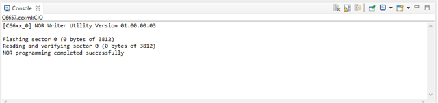

    Steps: --  Flashing the SPI-BOOT code into the NOR flash memory using the NOR-Writer utility.
    Now, after the step6, you will have the app.dat in ---- "C6657_directROM_Boot_example\C6657\SPIboot_ddr\bin\flashwriter" where the norwriter.out is present.
    1. Boot EVM in No Boot mode.
    SW3 {pin 0 - pin8) = 10000000 (0-ON, 1-OFF)
    SW5(pin0 - pin8) = 00000000
    2. Launch CCS and connect to C6657-core 0. Let the GEL file run to initialize PLL and DDR memory.
    3. Go to the bin/flashwriter and ensure that norwriter_input_txt points to "app.dat"
    4. In CCS load memory location 0x80000000 using memory browser. Load norwriter.out file and run.
    For full instructions for flashing the boot image to SPI NOR refer to README (C6657) in the NORwriter package in Processor SDK.
    Output console messages when executing NOR-Writer.out
    The same flashing steps are given in the video below.
