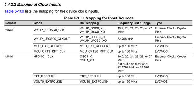

Referencing TRM DRA829/TDA4VM Technical Reference Manual (Rev. C) SPRUIL1C the below table can be seen.   Is the external clock for HFOSC1_CLK required?
  • As listed in the table above:
    • HFOSC0 is the primary reference the clock source for MCU domain and Main domain PLLs.
    • HFOSC1 the input reference clock for the Main domain PLLs only.
    Additionally, there is a low frequency external oscillator source for the WKUP domain LFOSC that is primarily to provide an accurate low frequency clock for use during lower power/sleep modes.
    Is HFOSC1 External Oscillator required?
    The SoC provides the option for two separate external oscillators for the Main(OSC1) and MCU(OSC0) domain to support customers who might use the SoC in mixed critical applications. This ensures that in the case of failure in one of the external oscillators, the other domain will remain functional and thus avoiding 'common cause failures' in using a single crystal for the whole SoC.
    Having two external oscillators is not a “Hard Requirement” for safety.  The chip is architected to be able to function on a single OSC(OSC0) for the entire MCU and Main domain and even if there is a fault in Main domain, the MCU domain can continue to operate using the OSC0. It is up to the system integrator to decide if a single or two crystal needs to be used in the specific application use-case. Some customers prefer using two separate OSC for MCU and Main domain, others choose one OSC for both MCU and Main domain.
