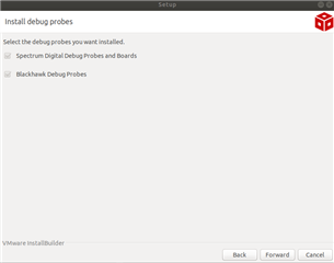

    3. Start up CCS, and if Blackhawk debugger drivers are not installed, go to Help->Install Device Support... which will restart the installer. Go through the installation until the "Install debug probes" screen is reached and check off Blackhawk Debug Probes, and continue forward until installation is finished.

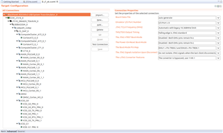

    5. Start up CCS and create new Target Configurations file with below settings in screenshot, that is, "Connection" is "Blackhawk XDS560v2-USB System Trace Emulator", and "Board or Device" is "EVM_J721E", and remove the gel file path (....emulationgelJ721E_DRA829_TDA4VMgelJ721E.gel) from DMSC cortex M3 settings.
    6. Info: If errors come up while connecting to cores or testing connection that mentions lowering TCLK, they can be changed in Advanced Setup->Target Configuration->Blackhawk XDS560v2-USB System Trace Emulator_0->Connection Properties->JTAG TCLK Frequency (MHz).

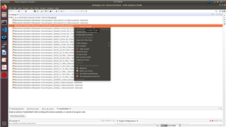

    7. Save configuration file, right click newly created configuration file, and launch. Following screen should show up.
    8. By default, the 8.4 SDK for SK-TDA4VM has the following cores up and running, as well as the A72 cores. Right clicking and connecting to any of the following cores should halt the core to load in symbols and programs.
