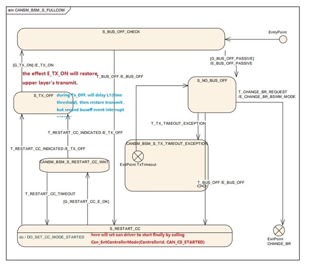

I generated busoff by shorting CAN_H and CAN_L, can driver successfully entered Can Interrupt, then notify upper layer. The upper layer start the recovery process. During this process, I keep shorting CAN_H and CAN_L.
I use recovery strategy of AUTOSAR CanSM, it will stop upper layer from calling Can_Write to transmit once received busoff event, then start can controller.
After start can controller successfully, it will delay L1(a time set before), then restore upper layer's transmit, so that upper layer can call Can_Write to transmit.
following is the stae machine of recover process
I meet a problem that the second busoff event generated during L1, and it interrupt the recovery process.
1. I wonder how the second event generated, cause there is no new transmit request from upper layer during L1.
2. Does Can diver re-transmit as soon as started, whether upper layer call can_write or not?
3. If it is, should I start can driver after L1 timeout, instead of start it before L1?

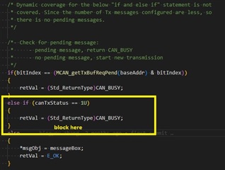

    If the recovery process isn't interrupted, the upper layer will request data transmission again.
    But it failed due to canTxStatus, which is cleared at the TxConfirm function. TxConfirm didn't be executed during Bus off. The code as follows
    /*- Check for pending message:
    * - pending message, return CAN_BUSY
    * - no pending message, start new transmission
    if(bitIndex == (MCAN_getTxBufReqPend(baseAddr) & bitIndex))
        retVal = (Std_ReturnType)CAN_BUSY;
    else if (canTxStatus == 1U)
        retVal = (Std_ReturnType)CAN_BUSY;//failed here
    During the time when data transmission consistantly failed, the BO bit of PSR is 0(not in busoff state).So the recovery process will block.
    SDK just reports the Bus_Off state.It is left to software to decide how/what to recover.
    Initially bus off event happened then recovery process has to start immediately .Now it is upto AUTOSAR CanSM recovery strategy how it does recovery.
    The bus off recovery procedure involves sending a sequence of error frames to bus to clear any pending errors .After the error frames have been sent ,CANsm will wait for a specified time before attempting to re establish communication on the bus.

    And for canTxStatus issue, Can I clear canTxStatus (canTxStatus = 0) when busoff occured?  so when can controller start and the upper layer request data transmission, it won't block in following process.
    And the busoff recovery process will keep going. If the new data transmission fail, it will trigger next recovery process, and repeat util recovery success.
    Also need you help me to confirm that the modification(clear canTxStatus when busoff occured)OK? If it's not, how can I do to avoid new data transmission block here.
    Thanks !
    Can you help me to confirm that my modification below about check of busoff OK?
    If it's not right, how do I check busoff state?
    I think this is OK. Checking PSR register BO bit will give the absolute status.
    Rather than making only CanTxStatus =0 after cancelling pending messages, it is better to make all the cancelled pending messages CanController->CanTxStatus to 0.
