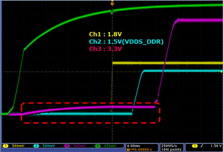

A customer of ours is building a custom board using the AM4378.
In the board they are currently building, the power is supplied from the PMIC (TPS65218D0) to the CPU (AM4378).
AM4378 does not use RTC, and IO voltage is used under the condition of 2 voltages (3.3V and 1.8V), so it should be activated in the order of 1.8V → VDDS_DDR(1.5V) → 3.3V as shown below from the power-up sequence (Figure 5-7.) described in the data sheet.
After checking the waveforms of the board they created, as shown in the figure below, the order in which the specified voltage of each power supply is reached is as required: 1.8V → VDDS_DDR(1.5V) → 3.3V, but in the area enclosed by the red dashed line, the voltage is reached via IO (I2C interface) with another board → PU resistor for I2C (1k The red dashed line indicates that the voltage is increased by about 0.25V for a period of 24ms due to the power supply sequence to the AM437x.
Please confirm if there is a problem with the power supply sequence to AM437x.
    Can you please share some inputs on the I2C interface used and the connections.
    I assume the pink line is the 3.3V.
    Help \me understand the green trace please.
    Sreenivasa

    Yes, the pink line is 3.3V (the letters in red in the diagram are wrong).
    What do you need to know about the I2C interface?
    I believe the green line is VIN_BIAS, but I am checking just to be sure.

    The i2C interface does not seem to be fail safe. So i am trying to understand  the I2C interface connection from processor to attach device and the pullup source.
    The USB0_VBUS, USB1_VBUS, and DDR_RESETn are the only fail-safe IO terminals. All other IO terminals are not fail-safe and the voltage applied to them should be limited to the value defined by the Steady State Max. Voltage at all IO pins parameter in Section 5.1.

    Both of these boards are supplied 5V at the same time, but the 3.3V on the OtherBoard seems to start up faster and I believe the potential is rising through the I2C line.
    For the K22/L22 pins that are connected, we believe that the BALL RESET STATE is high impedance according to the Pin Attributes in the DataSheet, and we want to confirm that there is no problem if the timing is as previously indicated.

    I assume the i2C interface on the other board is open drain and has pulls.
    We are recommending powering the processor and the attached devices from the same power supply.
    Try removing the pulls on K22/L22 for testing.
    This configuration is not recommended for implementation.

    The AM437x IOs are not fail-safe and the interface that you have shown is not a valid use case that has been tested.
    The issues could be functional failures and reduced device reliability or operational life.

    The voltage that you mentioned is: Steady State Max. Voltage at all IO pins(5) –0.5 V to IO supply voltage + 0.3 V
    This assumes IO supply is available.
    We do not allow any current (Injection current) on the IOs. These could affect the long term reliability. It depends on many factors including the duration the current is seen.
    Any thoughts on the pull used on the other board that is interfaced.

    After talking to the customer, we have decided to work around the current draw from the I2C interface with a hardware change.
    They haven't decided on a concrete plan yet, but let me close this time.
