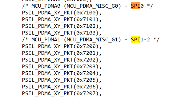

    And added the UDMA of PSIL for MCU_SPI1 in k3-psil-j721s2.c:
    When I run spidev_test, it would stuck and cannot leave with [Ctrl+c].

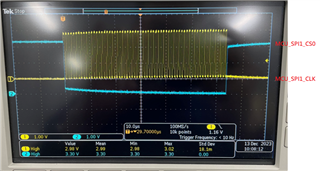

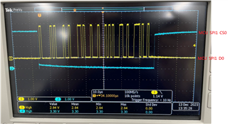

    2. I measured the MCU_SPI1_CS0, MCU_SPI1_CLK and MCU_SPI1_D0. Please refer to below pictures.
    The spidev_test still stuck and cannot exit with [Ctrl+C].

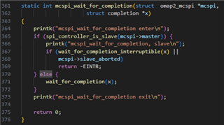

    I added some debug message and from the log, it stuck in wait_for_completion_interruptible() when calling omap2_mcspi_rx_dma().

    [  136.121914] mcspi_wait_for_completion enter
    [  136.126090] mcspi_wait_for_completion, slave

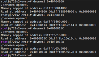

    3. I run devmen2 command to read the values for MCU_SPI1_CLK/MCU_SPI1_CS0/MCU_SPI1_D0/MCU_SPI1_D1.
    root@j721s2-evm:~# devmem2 0x4301c0c0
    /dev/mem opened.
    Memory mapped at address 0xffff802c3000.
    Read at address  0x4301C0C0 (0xffff802c30c0): 0x00050000
    root@j721s2-evm:~# devmem2 0x4301c0cc
    /dev/mem opened.
    Memory mapped at address 0xffff88220000.
    Read at address  0x4301C0CC (0xffff882200cc): 0x00050000
    root@j721s2-evm:~# devmem2 0x4301c0c4
    /dev/mem opened.
    Memory mapped at address 0xffff8b9e5000.
    Read at address  0x4301C0C4 (0xffff8b9e50c4): 0x00050000
    root@j721s2-evm:~# devmem2 0x4301c0c8
    /dev/mem opened.
    Memory mapped at address 0xffff9407f000.
    Read at address  0x4301C0C8 (0xffff9407f0c8): 0x00050000

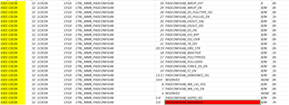

    Check 1 :  Find something different in PADCONFIG
    Pin define
    D26, MCU_SPI1_CLK -> 0x4301C0C0 , (WKUP_PADCONFIG_48)
    E24, MCU_SPI1_D0 -> 0x4301C0C4 , (WKUP_PADCONFIG_49)
    C28, MCU_SPI1_D1 -> 0x4301C0C8 , (WKUP_PADCONFIG_50)
    C27, MCU_SPI1_CS0 -> 0x4301C0CC , (WKUP_PADCONFIG_51)
    So we try to dump register setting as below.

    Pin mode is correct for D26, E24, C28, C27, but one of "PADCONFIG5x_RXACTIVE" (bit 18)  for  MCU_SPI1_D0 or MCU_SPI1_D1 should be wrong
    for example, if we let MCU_SPI1_D0 as MISO, the return value should be 0x00010000
    Do you agree?

    Check 5: Need check UDMA value
    dmas = <&mcu_udmap 0xf200>, <&mcu_udmap 0x7200>;
    dma-names = "tx0", "rx0";
    Why mcu_udmap = 0xf200?

  • Pin mode is correct for D26, E24, C28, C27, but one of "PADCONFIG5x_RXACTIVE" (bit 18)  for  MCU_SPI1_D0 or MCU_SPI1_D1 should be wrong
    Should be okay. RX_ACTIVE can be for both.

    Let's me make a conclusion, If you want to use MCU_SPI1 or MCU_SPI0 for slaver mode, you need :
    1) Follow previous discussion, check "pad config mode"  setting, it should be mode 0
    2) MCU_SPI1 "internal connect" to main domain MCPSI3 by default, so you need to set external pad pinout, check as below
    (This check just for MCU_SPI1 only)
    * MCU_SPI1_CTRL[SPI1_LINKDIS] --> 40F0 4060h, bit 0 = 1;
    * MCU_SPI1_CLKSEL[MSTR_LB_CLKSEL]  --> 4300 8114h, bit 16 = 1
    * SPI3_CLKSEL[MSTR_LB_CLKSEL]  --> 0010 819Ch, bit 16 = 1
    * MCSPI_MODULCTRL --> 4031 0128h, bit 2 = 0
    3) Check Reg MCSPI_MODULCTRL bit 2, it tells you setting in Master/Slaver mode
    4) Check Reg MCSPI_SYST bit8~10, it sets D0 or D1 data direction. (MOSI/MISO)
    5) Check Reg MCSPI_CH0CONF  --> Assume CH0 only
    6) Check Reg MCSPI_CH0CTRL
    7) Check Reg MCSPI_TX0 --> TX data buffer
    8) Check Reg MCSPI_RX0 --> RX data buffer
    9) Check Reg MCSPI_CH1CONF
    Gibbs
  • Hi, Gibbs:
    I set the 0x40f04060 to 0x1 and MCU_SPI1 can receive data from the connected Master.
    But for other registers, they seems don't meet the settings.
    Should we need to configure them to meet your descriptions ?
