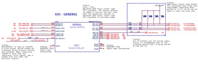

    Schematics - Design Value Updates

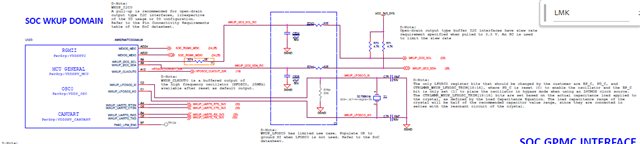

    I2C pullup is recommended irrespective of IO usage for MCU_I2C0 and WKUP_I2C0
    AM62x, AM62L, AM62Ax and AM62Px processor families (I2C0 and MCU_I2C0 for AM642/AM243x)
    MCU_I2C0 - Pullup and RC added for slew rate control when pulled to 3.3V
    WKUP_I2C0 - Pullup and RC added for slew rate control when pulled to 3.3V
    Note: The below diagram is for AM64x and the same can be used for AM62x, AM62L, AM62Ax and AM62Px processor families
    These I2C interfaces are Open drain type IOs. These I2C interfaces are fail-safe IO terminals.
    The rise and fall times of the I2C signals connected to these ports must not exceed a slew rate of 0.08 V/ns (or 8E+7 V/s). This limit is more restrictive than the minimum fall time limits defined in the I2C specification. Therefore, it may be necessary to add additional capacitance to the I2C signals to slow the rise and fall times such that they do not exceed a slew rate of 0.08 V/ns.
    Refer below

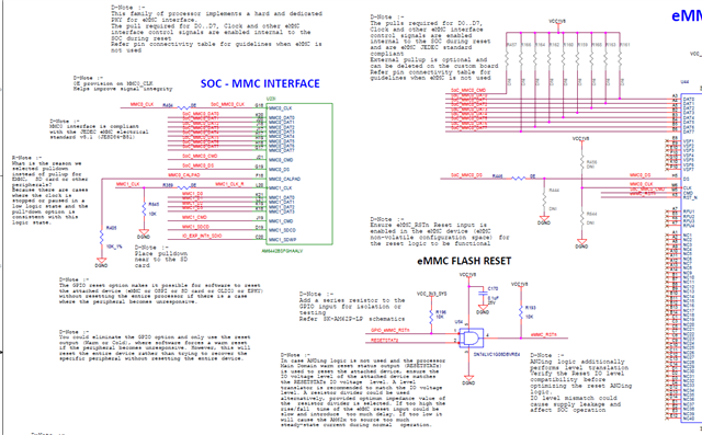

    eMMC attached device supply decap
    Add decaps as required to the eMMC memory supply rails

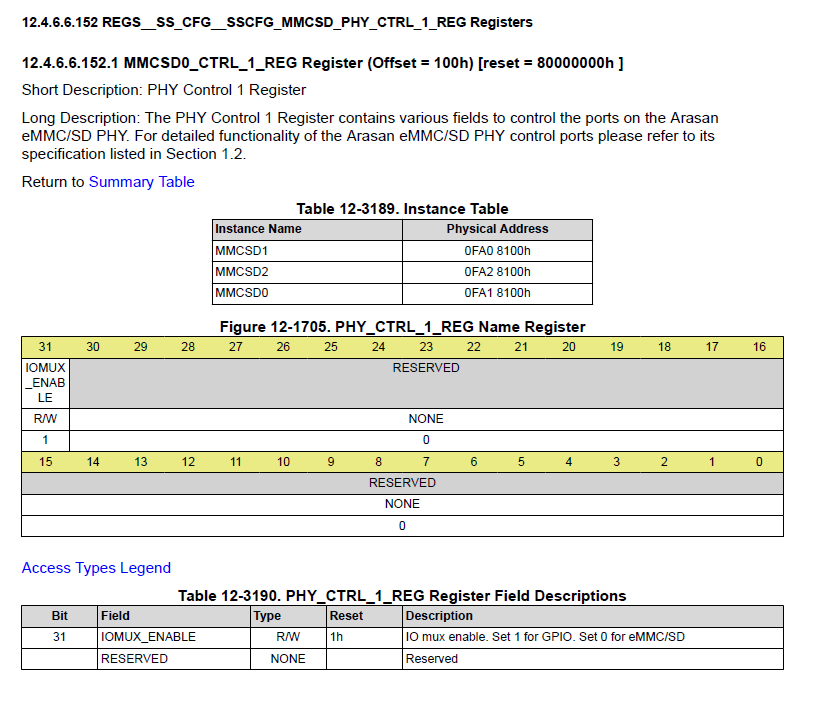

    eMMC interface pulls for AM62x, AM62A and AM62D that implements soft (IOs support alternate function) eMMC PHY
    eMMC interface pulls for AM64x and AM62Px  that implements hard (IOs do not support alternate function) eMMC PHY
    Please refer to the errata.
    https://www.ti.com/lit/er/sprz574a/sprz574a.pdf
    i2458 MMCHS: eMMC HS400 tDCD timing marginal to JEDEC spec

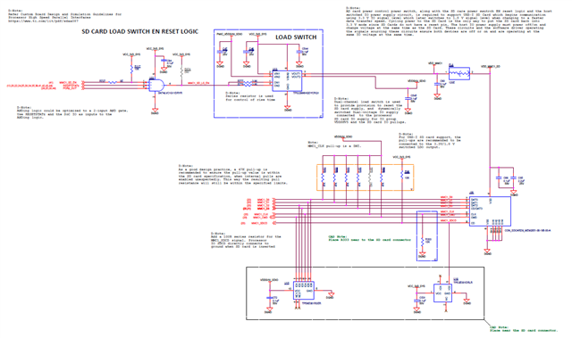

  • Hi Board designers,
    To implement UHS-I refer below steps:
    The SD card interface pullups have to be connected to the 3.3V_1.8V VDDSHV_SDIO switched supply output from the PMIC or discrete LDO or integrated LDO
    Discrete LDO
    The SD card needs to be powered using a fixed 3.3V supply.
    The 3.3V supply to the SD card needs to be switched through a power switch
    Provision to reset the power switch using SOC IOs is recommended
    Processor IO supply sequencing
    VCC_3V3_SYS LOAD SWITCH
    SoC IO supply rails have slew rate requirements specified.
    Refer Power Supply Slew Rate Requirement section of the data sheet.
    Add a cap 220 pF or higher on the Load switch CT (Switch slew rate control) pin.
    An ANDing logic is recommend to reset the SD cars power switch.
    The SOC VDDSHV5 supply needs to be connected to the .3V_1.8V VDDSHV_SDIO switched supply output from the PMIC
    Integrated LDO
    AM64x EVM
    AM64x SK
    On the SK-AM64B there are 2 options to power the VDDSHV5. Using integrated LDO (AM64x supports integrated LDO) or use PMIC LDO output.
    The SK is configured to use the integrated LDO and the PMIC LDO output is not connected.
     It is OK to connect VDDSHV5 supply to any of the 2 supply sources.
    i'm refering the data sheet(www.ti.com/.../am6421.pdf) chapter5.4 Pin Connectivity Requirements.
    There is no information for MMC1 at there. How each MMC1 pins should be treated when MMC1 is unused?
    All of the pins associated with the MMC1 port default to an off state, so you do not need to do anything to them if not being used.
    See the highlighted portion of the following note, which can be found below the Pin Connectivity table.
    Internal pull resistors are weak and may not source enough current to maintain a valid logic level for some operating conditions. This can be the case when connected to components with leakage to the opposite logic level, or when external noise sources couple to signal traces attached to balls which are only pulled to a valid logic level by the internal resistor. Therefore, external pull resistors are recommended to hold a valid logic level on balls with external connections.
    Many of the device IOs are turned off by default and external pull resistors may be required to hold inputs of any attached device in a valid logic state until software initializes the respective IOs. The state of configurable device IOs are defined in the BALL STATE DURING RESET RX/TX/PULL and BALL STATE AFTER RESET RX/TX/PULL columns of the Pin Attributes table. Any IO with its input buffer (RX) turned off is allowed to float without damaging the device. However, any IO with its input buffer (RX) turned on shall never be allowed to float to any potential between VILSS and VIHSS. The input buffer can enter a high-current state which could damage the IO cell if allowed to float between these levels.
    Start-up issue due to SD card power switch
    https://e2e.ti.com/support/processors-group/processors/f/processors-forum/1318441/faq-am625-am623-am62a-design-recommendations-commonly-observed-errors-during-custom-board-hardware-design-sk-schematics-updates-for-design-update-note
    Note:
    It is not possible for AM64x or AM62Px because SD Cards begin operation at 3.3V and the MMC0 port on these devices is limited to 1.8V.
    We do not expect SD Cards to be connected to the MMC0 port of AM62x, AM62Ax, AM62Dx, or AM62Lx.  SD Cards should be connected to MMC1 or MMC2 of these devices.  However, we do allow SDIO embedded devices to be connected to the MMC0 port of these devices.
    Implementation of ANDing logic for attached device reset
    eMMC
    EPHY

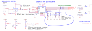

    Ethernet interface (MAC)
    Ethernet PHY EPHY reset recommendations
    Option 1
    Option 2

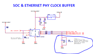

    EPHY clocking
    AM64x
    AM62x
    (27) [FAQ] AM625 / AM623 / AM620-Q1 / AM625-Q1 / AM625SIP: Ethernet PHY RGMII synchronous clock - Processors forum - Processors - TI E2E support forums
    (+) [FAQ] AM6442, AM6441, AM6422, AM6421, AM6412, AM6411 and AM2434, AM2432, AM2431 (ALV, ALX) Custom board hardware design - Ethernet - Processors forum - Processors - TI E2E support forums
    (27) [FAQ] AM625 / AM623 / AM620-Q1 / AM62Ax / AM62Px / AM62D-Q1 / AM62L / AM64x / AM243x Design Recommendations / Custom board hardware design - Queries related to RGMII interface and RGMII TI EPHY - Processors forum - Processors - TI E2E support forums
    [FAQ] AM625 / AM623 / AM620-Q1 / AM62Ax / AM62Px / AM62D-Q1 / AM62L / AM64x / AM243x Design Recommendations / Custom board hardware design - Queries related to RMII interface and RMII TI EPHY - Processors forum - Processors - TI E2E support forums
    (28) SK-AM64: clock sync - Processors forum - Processors - TI E2E support forums
    we are currently evaluating AM64xx on the SK-AM64: is there an easy way to use the 25MHz system clock via a CLKOUT pin for external peripherals
    to be brought out and used without changing various PLL clocks / multiplexers and dividers via registers?
    Basically to have 3x GPIO as CLOKOUT sync'd ( I'm looking for a solution to feed up to 3x external Ethernet PHYs with 25MHz ).
    OBSCLK0 is the only AM64x clock signal that is not generated from one of the internal PLLs. However, this clock output is only multiplexed to one pin. Software would need to configure the pin multiplexer to select this function and there is no way to prevent the attached device from seeing a short clock since the mux mode change is not synchronized to the clock output. This clock output is only provided as an observation clock.
    Your customer should consider the approach implemented on the AM64x EVM, where an external LVCMOS clock source is used as the system reference clock and distributed to multiple devices. Note: This approach requires a single input to multiple output buffer so each device receives its clock from a dedicated clock output with point to point connectivity. Any attempt to clock multiple devices from a common clock output is likely to be problematic.

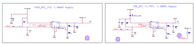

    AM62L RTC only Discrete LDO implementation
    Information related to clock pulldown
    e2e.ti.com/.../faq-am625-what-s-the-purpose-for-the-pull-down-r-on-mmc_clk
    May I know what the purpose for the pull down R on MMC_CLK signal on TI EVM? May I know what the purpose for the pull down R on MMC_CLK signal on TI EVM?
    Most of the IOs associated with the AM62x device default to the off state, which means any attached device input without an internal pull resistor would be floating until software configures the pin to drive the signal. We use an external pull-down rather than an external pull-up since the clock signal is held in a low logic state when paused.
     Because there are cases where the clock is stopped or paused in a low logic state and the pull-down option is consistent with this logic state.
    Sreenivasa

  • Hi Board Designers,
    Refer below inputs regarding SD card power switch reset logic implementation:
    AM62P5-Q1: RESETSTAT and PORz_OUT for SD card power enable.
    Customer is considering to adopt AM62P for their system. Then they are confirming the schematic of AM62P.
    In the schematic of AM62P EVM, RESETSTATz and PORz_OUT are ANDed to the SD Card power enable signal.
    Customer also understand that RESETSTATz is also asserted when PORz_OUT is asserted.
    Is this understanding, correct?
    Is the circuit like this because the timing is slightly different when asserting?
    In that case, please tell us what the timing between RESETSTATz and PORz_OUT.
     The system power on reset is connected to ensure the card power is forced off as soon as power is applied since this reset is expected to be valid while power supplies ramp.  The RESETSTATz is included so the SD Card is power cycled (Reset) if there is a processor warm reset source like a watchdog time-out. The GPIO is connected to allow the software driver to reset (cycle power) the SD Card.
    The RESETSTATz will not be valid until all AM62Px power rails are valid, so it is delayed relative to the system power on reset.
    Sreenivasa

    https://e2e.ti.com/support/processors-group/processors/f/processors-forum/1115074/faq-am625-mmc-interface
    • The boot code in AM62x only supports booting from an CD Card on MMC1.
      MMC1_SDCD and MMC1_SDWP pins are powered from the VDDSHV0 power domain. So they must operate at a fixed voltage that is the same for all IOs associated with VDDSHV0. Each of these signals should have an external pull-up resistor connected to the same power supply that powers VDDSHV0. They are also connected to their respective switch in the SD Card connector, where the other side of the switch is connected to ground. The operating voltage of these signals is completely independent of the SD Card IO operating voltage since these signal do not connect to the SD Card. They do not need to change their operating voltage like the other MMC1 signals when using one of the higher speed data transfer modes supported by UHS-1 SD Cards.
    • Regarding the SD card power rail, if we  locked the power rail “VDDSHV0” to be 1V8, is there any risk besides we only use the ultrahigh speed SD card
    • The only pins associated with MMC1 that are powered from VDDSHV0 are MMC1_SDCD and MMC1_SDWP.  These pins are not connected to the SD Card. They only connect to switches in the SD Card connector and should be pulled high with an external resistor connected to the same supply that is powering VDDSHV0. The other side of the switches in the SD Card connector are connected to ground to indicate a card is present or the write protect switch is on.
      All of other MMC1 pins are powered from VDDSHV5. These pins are connected to the SD Card, where they are required to begin communications with the SD Card using 3.3V and only change to 1.8V after the host negotiates a voltage change with the card. This is the way SD Cards work to ensure they are backwards compatible with older systems.  So your VDDSHV5 supply must always default to 3.3V when power is applied and designed to change from 3.3V to 1.8V when software is ready to change the operating voltage of these pins. The SD Card is always powered from a switched 3.3V supply since it has internal circuits that switches its IO voltage at the same time. Note: the SD Card must have a software controlled 3.3V load switch that allows power to be cycled since this is the only way to reset the card and place it back into its default state.
      You may need to read the SD Card standard to understand all of the details required to implement a system that supports the more complicated UHS-1 cards.
