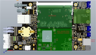

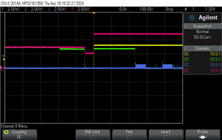

Contextualizing about the hardware... Dedicated SOM module based on the BBB but with the am3354. Kernel v5.15.43. Dedicated interface board for the application using various processor peripherals. The issue at hand is with my USBs, where USB0 was initially intended for expansion in a type A connector, and USB1 was provided on a board-to-board connector to accommodate a customized module with the Quectel eg915u 4G Modem.
USB0
USB1 QUECTEL MODULE
USB1 INTERFACE BOARD

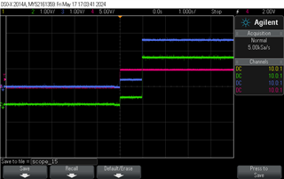

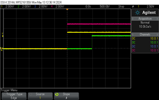

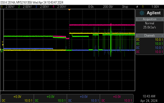

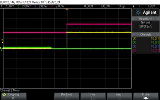

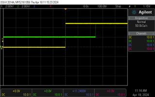

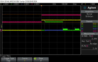

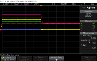

The USB2.0 connected to USB0 worked normally in my tests acting as a host, but my USB1 with the eg915 module did not.
I re-evaluated the circuit and found that controlling vbus was necessary for proper interaction of the module with the driver provided by the manufacturer. I made the necessary modifications by adding the vbus controller (TPS2051) and its connections with the USB1 pins, but still had no success with the Quectel module connected to USB1.
Still unsure about the sources provided for integration into the kernel by the 4G module manufacturer, I swapped the USBs with hardware wireups (yes, I connected everything related to USB0 to USB1, vbus, enable, OC, ID, N, P), forgetting the best practices for USBs, and to my surprise, the 4G module worked perfectly. I was able to use it normally in my application.
With this validation done on more than one hardware, I concluded that my vbus control is correct and therefore USB2.0 should work when connected to USB1 of the processor. However, I never managed to succeed with both USBs connected.
I still doubted whether the brief modifications made to the kernel sources could interfere with something, so I tested with and without modifications, but without success.
I believe it is no longer a hardware problem but a kernel configuration issue. With the oscilloscope, I made some measurements and the vbus of USB0 and USB1 rise normally.
I did some research and found nothing with the same usage. I tried some tests with the .dtb enabling only one device as a host and still without success. What works for USB0 is the one inserted in the first image below, similar to the BBB, even removing the interrupt controller USB0 still works. Inserting the interrupt controller into USB1, intc 19, still does not work.

    Can you please use a scope to capture the USB1 signals of USB1_VBUS, USB1_DRVVBUS, and USB1_DP/DM during Linux boot? I'd like to see the timing of these signals, around the time when USB1_DRVVBUS goes high.
  • USB1_VBUS - RED
    USB1_DRVVBUS - YELLOW
    USB1_DP - GREN
    USB1_DM - BLUE
  • Here is a printout with the USB2.0 device (pendrive) disconnected.

    In the first graph, I don't think it is relevant to the 4G modem enumeration failure, but do you know why USB1_VBUS is at about 3.3v before USB1_DRVVBUS goes from 0v to 3.3v? USB1_VBUS supposes to be 0v before USB1_DRVVBUS is turned on.
    In the second graph, two questions:
    1. you didn't mention pendrive in your first post. What is the context? Does the pendrive enumeration working fine on USB1? I thought your board USB1 uses special connector to the 4G modem, how can you connect a pendrive to USB1 connector?
    2. more importantly, are you sure this capture is about the pendrive disconnect? both USB1_VBUS and USB1_DRVVBUS go high, this seems to be device connect not disconnect.
  • Hi Bin Liu,
    First Graph
    Yes, I also found the behavior of USB1_VBUS strange; unlike this, USB0 goes to 0V during reboot. I will investigate and comment on this topic.
    Second Graph
    1 - Yes, initially the pendrive was connected to USB0 via a USB type A connector, and the 4G module was connected to USB1 via a board-to-board connector. However, since my priority was to make the 4G module work, I swapped the USBs (all pins) via hardware as a test for validation. Enumeration always works for USB0, never for USB1 regardless of the connected device.
    2 - It wouldn't be about disconnection, perhaps I expressed myself poorly; it would be about initialization without the pendrive connected to the USB1 bus. The signal is triggered on USB1_DRVVBUS for both graphs.
  • Hi Vinicius,
    You can run command 'devmem2 0x47401c60 b 0' without any USB device connected to USB1, this command set USB1_DRVVBUS low, then you can check if USB1_VBUS is still high, and why it is high.
    Okay, I understood now - it is when nothing is connected to USB1.

    Returning... In the first test in which we were successful, I swapped between the devices where the Queqtel eg915 module was connected to USB0 through a board-to-board connector. At USB1 I connected a pendrive via USB type A.
    In the new test I connect the pendrive to USB0 which is recognized normally, as expected, but the Quectel module to USB1 does not work.
    Below usb signals with trigger on USB1_DRVVBUS

    In dmesg nothing appears when connecting or disconnecting the device, however I have a reset pin for this module controlled via a am3354 gpio, when I run it, USB_DM/DP leave 1>>0 and then immediately return to 1 as in the signal shared below.

    Yes, I would say that it is no longer an integrity problem, but I cannot see the USB device listed, for the system the device is not connected, it does not appear in any log.
  • In the scope screenshot you provided last Friday, it seems USB1_VBUS doesn't have the 3.3v prior USB1_DRVVBUS high problem anymore. What is the hardware difference between the two boards?
    Can you please remove 'maximum-speed=full-speed' from DTS to see if kernel log has anyUSB1 enumeration message?
  • A picture of the hardware to help you understand.
    Correct, I no longer have the problem with the voltage in USB1_VBUS.

  • Please capture the USB1 signals on a scope in this test.
  • I executed the commands and USB1 is still not numbered and neither is the change in signals when switching between commands.
  • This is very strange, 'echo 0 > .../softconnect' should set USB1_DRVVBUS to low.
    Does command 'devmem2 0x47401c60 b 0' set USB1_DRVVBUS to low?
  • Does command 'devmem2 0x47401c60 b 0' set USB1_DRVVBUS to low?
    Yes, normally.
  • devmem2 0x47401c60 b 1
  • Okay, devmem2 commands can toggle USB1_DRVVBUS. Not sure why softconnect doesn't work on your board, but we can ignore it...
    The USB signals all look correct, except the DP/DM handshake doesn't happen. I don't know why.
    Can you remove the modem from USB1 port but connect a USB pendrive to see if it enumerates?
  • When you probe the USB signals, do you probe them on the main board or the SOM? Please ensure to probe DP line close to AM335x device, I am wonder if the board has routing error and AM335x doesn't see the DP signal.
    So I think we've reached a good point, for me this is what's needed for the device to fully function.
    It's not an easy task, since the pitch between pins of the boad-to-boad connector is small, but I can try with jumpers. Previously, with the USB signals switched, it worked. I will make the modification and bring results.
  • My probes are closer to the device, the closest I could get would be through roads currently, don't leave testpoints on the USB, I didn't think there would be so many problems. :(

  • Not sure I understand the entire picture, so let's reset.
    Instrument DP/DM and VBUS. Run your test.
    In order:
    1) VBUS reaches 5V.
    2) Attached Device asserts DP high (in this case).
    3) Host issues RESET (DP and DM both driven low)
    4) During this RESET, attached Device will drive DM to ~800mV for 1ms minimum.
    5) Host sees this and begins driving K/J pairs on bus at ~800mV.
    Post your scope plots. Any deviation from above is a problem.
  • Hi, sorry for the delay, I requested more samples to be produced.
    Below measurements.
    Red - VBUS1
    Blue - DM
    Green - DP
