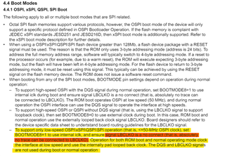

  • Hello Thomas Mongellaz
    Please refer to the TRM Bootmode section. Looks like the boot is configuring the below pin irrespective of the configuration.
    Please let me know your thoughts.
    Sreenivasa

    In TRM :
    in "AM64x and AM243x Schematic Review Checklist" documentation :
    I read in the TRM that when using the no loopback mode, nothing should be connected to LBCLK. However DQS is not mentioned in the TRM. whereas in documentation "AM64x and AM243x Schematic Review Checklist" it is recommended to disconnect LBCLK and DQS.
    To be sure when we do not use DQS, is it best to leave floating this input with no trace ?
    If the DQS remains connected to a trace when not in use, can it cause functional issues?

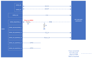

  • Hello Sreenivasa,
    thank you for your reply.
    My design :
    • In my design I placed a 0R resistor close to the ball of the AM64 so that I can disconnect DQS when it's not in use.
      Based on what you've told me, it's not necessary to disconnect DQS the pulldown is enough. Or is it better to disconnect (DNI 0R resistor) DQS when it's not in use ?
    • If I understand correctly, if we leave DQS connected while it is driven by a DEVICE (for example, OSPI) and it has a pulldown, but we use a mode without DQS (for example, no loopback), it does not a issue for the AM64 It ignores this input ?
    Thomas
    Thank you.
    The DQS is an SOC input. The 1K pulldown is required when a trace is connected to the SOC DQS pin nearest to the SOC.
    A 0R should be placed near to the memory device to disconnect DQS to the SOC based on the use case.
    If no trace is connected to the SOC DQS the need for pulldown does not arise.
